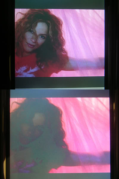

This is what i'm talking about, I don't know whether we're talking about the same thing or not. This is the way blacks appeared on my iPhone.
Yes, that is what I mean by the negative blacks problem - fixed on my Wk 40. No, that's not the problem I'm describing here with viewing angles creating image 'shimmer'. Actually, it's impossible to show in a photo, since the camera lense is viewing from one angle only ... you'd have to take two shots, eye-distance apart on left and right of image ... 🙂
See, the thing is, when I did have the phone (don't anymore, returned it unfortunately), I tried that one eye at a time thing, and with my left eye the screen looked shimmery and real dark, and with my right eye, the screen looked fine - which is why I think we're talking about the same thing.
We really aren't talking about blacks being inverted anymore as in your photos - I'm not seeing that.
But since the viewing angle problem has been the same with *all* models, the shimmer was visible with the faulty 'negative blacks' models too ... so in that sense we are talking about the same thing.
Two problems, one of which has been solved, the other of which hasn't ... 🙂
