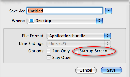

The first way mentioned didn't work. I compiled the script as a .app but it prompted to be run rather than just going right ahead and doing it.
Make sure that the following check box is clear
The method outlined on that site you linked to - dragging the app to the login items seems to work exactly as i need it to. Thanks!
