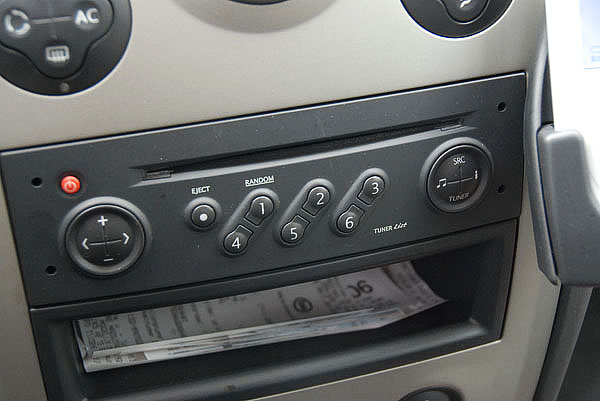

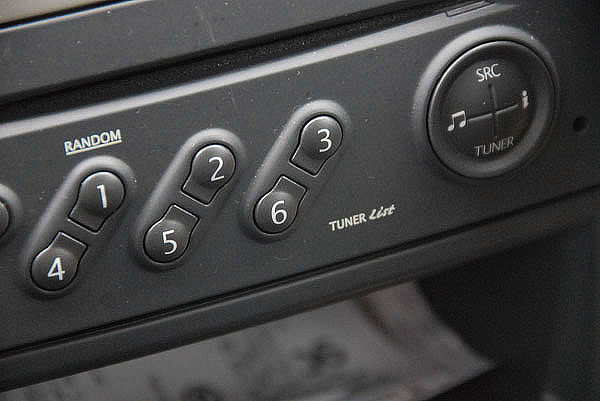

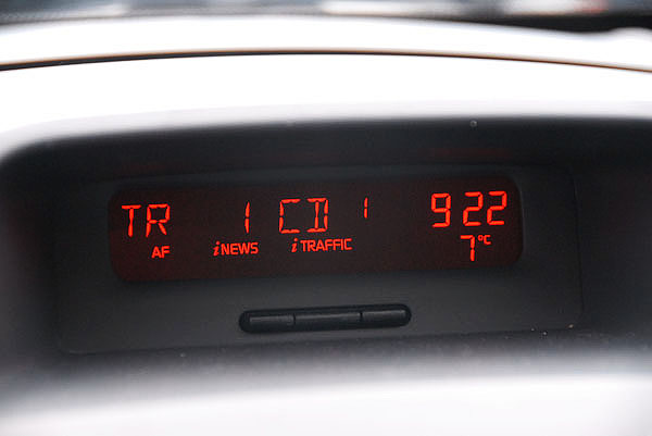

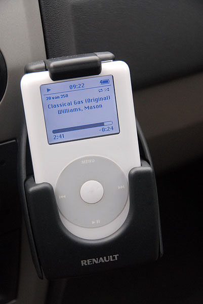

I got dension built in my renault. It acts like a CD changer.
