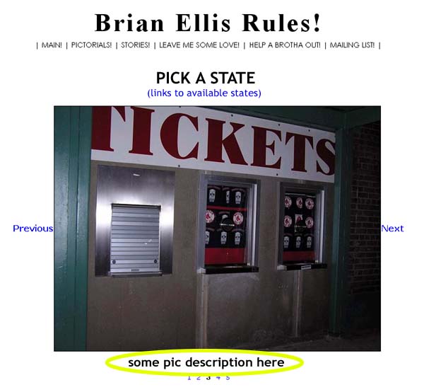

Anyhoo, what I want to do is shown in the attached picture. The top title/menu part is all taken care of. The "pick a state/links" part shouldn't be a problem for me now...
The picture, as well as the "next", "previous" and the numbers are all done with the phpimageview script. No problems there.
The problem is tieing in a picture description with each picture. Based on my limited experience thus far, it seems like the logical way to go about it would be to use another mysql database/field and add the descriptions in there. From there, do some sort of fancy-pants linking beyond the random image that was grabbed and the description of that picture from the mysql database.
Anyone have any better ideas? Any tips? Any pointers? Any code they want to do for me? 😉

Yup, I'd say definitely try to pull the description in from the DB. The question is: how can you integrate it into phpimageview's (PIV) code?
How does PIV set the image file? Variable? Filename? If you can figure out the variable and/or filename structure it uses, you can tack on a DB query to grab the image description.
Well, here's phpimageview in its entirety... I'm struggling to understand how it works...
It seems like he just opens whichever directory this file is in, and extracts all the *.jpg, *.gif, *.png files. There's an array in there somewhere... a lot of arrays maybe... a lot of variables.... head spinning...

It looks like it's just '$pic', so...
Just toss in a MySQL query that selects the description that matches the filename. Something like:
PHP:
$Link = mysql_connect ($Host, $User, $Password);
$Query = "select * from $TableName where pic='$pic'";
$Result = mysql_db_query ($DBName, $Query, $Link);
$desc = mysql_fetch_array($Result);
echo "$desc[text]";
The $desc[text] pulls the value out of the $desc array with the field name "text", so change it to whatever's appropriate.
The rest is, hopefully, clear. 🙂
Hmmm, it seems so simple... what's the catch? 😉
Thanks for the help (again). Hopefully I'll have some free time today so I can give it a shot.
It works! Woohoo!
