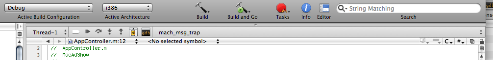

Sounds like you set a breakpoint on some code somewhere and the debuger has stopped at that breakpoint waiting for you to continue or whatever.
Along the top of the file editing window you should see a row of controls. One looks like a Pause/Play button for audio players. Try clicking on it.
The other alternative is some code was deleted that starts up the GUI. Check the startup portions of your app and see if something doesn't look right.
There's a new feature of Xcode 3 that allows you to make a "snapshot" of your project at any arbitrary point (kinda like Time Machine I guess). In the File menu select "Make Snapshot" and then you have a kind of backup of your project. You can make changes and roll them back later. View the snapshots in the "Organizer" in the Window menu.

I couldnt find a breakpoint set anywhere. I did click on the pause/play button and it didnt do anything. the only thing it showed in the organizer window was my iphone? I set a cout messages throughout my main function and none of them showed in the console. this is really frustrating. I can double click on the app under products and that will launch it, but id rather fix the problem than use a workaround. I even just made a new project that should just create a new window and that wont show either, nor do the cout messages show out to the console. no different.
