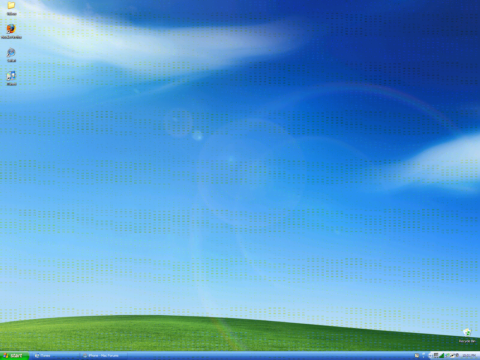

Is this my video card? i cant install drivers or anything or ill get a bsod. my dell xps is useless without my 7900gtx... so before i spend $300 i just want confirmation.

i havent changed anything. i was playing a game and i saw the screen flicker, then it went to a BSOD.
it looks like this CONSTANTLTY, within a second of me hitting the power button. 1600 x 1200 is the highest res i can use, but that's about it. if i install gpu drivers my computer wont even work and i have to boot into safe mode to uninstall them. then it works fine..
as you can see as well, i just reformatted and still no luck, but i figured that wouldn't fix it anyways..

does it in any resolution, any screen, in safe mode, on a BSOD, on the start up screen, on the dell logo screen, on the login screen, on the screensaver screen, everywhere.
It's a laptop. its a 17 inch, and a 7900GTX is a powerful card in a laptop, thus its expensive to replace. i dont have a mind paying for it, but as ive gathered from other forums, it HAS to be the gpu.

ive had this problem for about 2 weeks now. its had plenty of times to cool down, it's always been showing this.
i think its fried to be honest. i overclocked about 2 years ago and its been fine. and also, this all started while i was playing a game.
