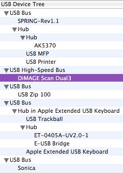

It should look like this in System Profiler.
Notice the High-Speed designation.

USB2 is only supported in 10.2.8 and higher unless you install third-party drivers. Otherwise the card will only be USB1 regardless of it's capabilities.
