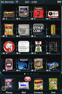

I have a 8Gb iPhone 3G and I jailbroke it, and I’m having some reception problems. I get the NO SERVICE display even though there is reception and to make it work again I have to restart the iPhone and the reception is back, eventually (after a couple of hours) the same thing happens, so the same process.

Good to know about no trace of a Jailbreak. Just making sure no new info on this exists either way. I Jailbroke my iphone 3G 2.2.1 (5H11) w/ Pwnage Tool about 6 months ago with no problems until a few days ago when I could no longer get service to make or receive calls or texts (can get wifi). The iPhone is still under warranty (unless warranty gets voided by Apple). I've called AT&T and Apple tech support and searched these boards with no luck in finding a fix to restore service signal. Next steps are a Restore via iTunes + possibly a trip to the Apple store if that doesn't help. 🙁

"No Service" problem on jailbroken 3G FIXED!
I restored the iPhone 3G 2.2.1 in iTunes 8.2 and the AT&T phone signal immediately returned! I thought for sure I'd need to restore then return it to the Apple store. Not sure, but it may have had something to do with updated carrier settings that were installed when I restored the phone? Maybe these settings did not update on on the Jailbroken phone causing me the loss of service. Anyhow, I miss my Jailbroken iphone but am hesitant to perform another Jailbreak after the experience. A bitter sweet resolution, I suppose. Glad it's now working though!
