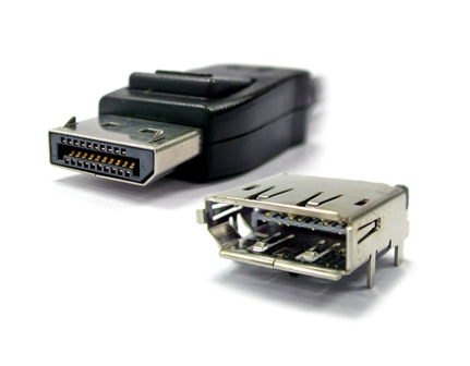

I don't imagine it will be too long before we see one hit the market (whether it's Apple that puts it out or not). Here's a comparison of Mini-DP to DP:
Mini-DisplayPort:
DisplayPort:
