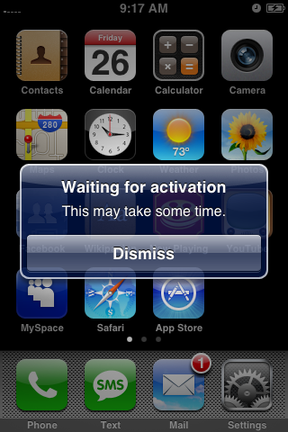

First i should note that this is my second iPhone and that the my first one was replaced due to the exact issues I am experiencing now. I will probably end up getting #2 replaced for the same reason.
Also I was wondering if it is true that if your serial number starts with a "5K" then your iPhone is a refurb.
My only crime is that I let the battery die. I plug it in and get this.
attachment.php
It never activates though because it is not getting a signal. It alternates between 1 bar and no bars (I always thought Apple/AT&T overestimated the signal) but it never connects to anything unless I use WiFi. So now my iPhone is USELESS as a phone.
So I do a restore. Now things get weird: there is an unavoidable lag when doing anything on the iPhone as if it's got something else on it's mind or it's getting stuck. Like if I'm entering my passcode it gets stuck on the first digit for about 10 seconds and then awknowledges the rest of my input and takes me to the home screen. Then after exactly 4 minutes later it restarts itself. And the restarting cycles does not stop. Not even after Recovery Mode.
My last iPhone seemed to get smart when I got to the Genius Bar; it proclaimed that there was a problem with the cellular reception or something (I don't have that screenshot... yet). A Genius Bar trip is in my near future and I will let ya'll know if I find anything else out or get any new screenies.
BTW, not jailbroken, unlocked, bounced off the ceiling, used as a frisbee or any other warranty-voiding activity.

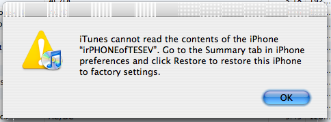

Sometimes when I restart the phone it wants me to connect it to the computer. Connect it to the computer and get this:
attachment.php
A hard restart/restore/recovery will usually make it stop - for a while.

Yeah, it would just deactivate sometimes. I dont think it was related to the battery, but just turning it off completely. It would not activate with itunes unless he restored it first. I had some activation problems on 1.1x, and that lockdown trick fixed it for me. It was an iTunes syncing problem though, the phone still worked fine.
I have power problems every time I let my battery run down really low...not dead but around 10%...it never wants to accept a charge.....I had to try to restore it 5 or 6 times before it would finally take and start charging again. It just freezes on the battery screen and doesn't every charge and won't go to the home screen.
This obviously isn't the problem that you are having, but just saying that I think there are funky things going on with some iPhones when the power gets low and I just don't get it....
