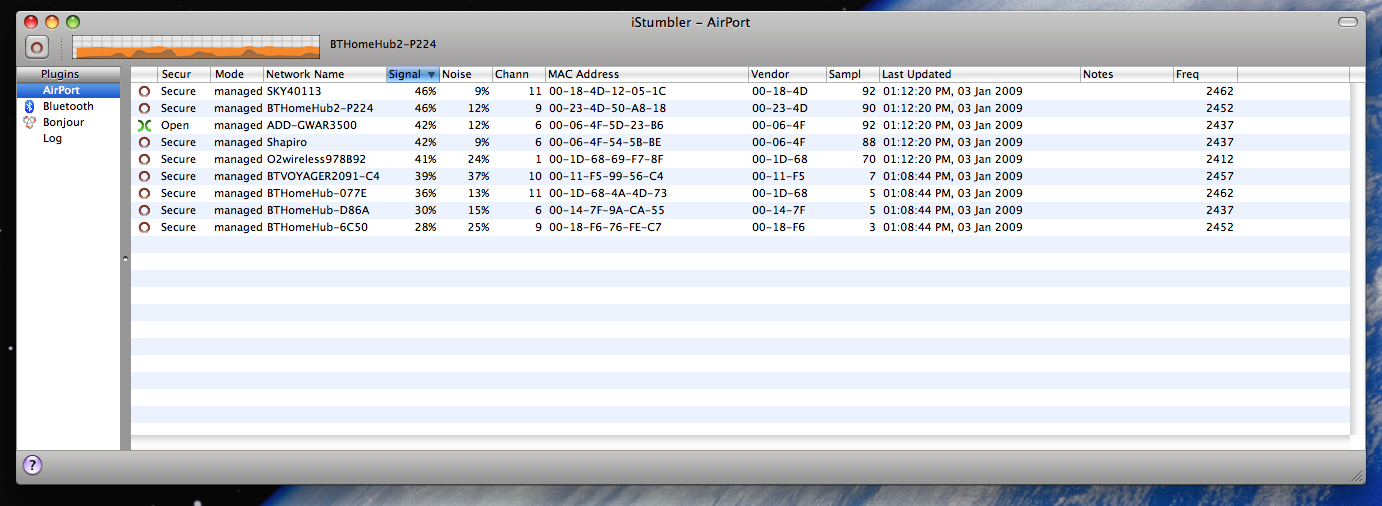

So I got the istumbler. I am attaching the picture of my airspace scan.
You can see there are quite a few channel 6s being used - any suggestions as to what channel to set based on this shot? - Currently I am on channel 7.
I wonder if there is a way to check noise on all channels (not just the ones that are being in use).
Thank you for your help!

Do you need anything to be wireless G compatible, I would seriously look at going straight N and apple tech support can walk you through this.
