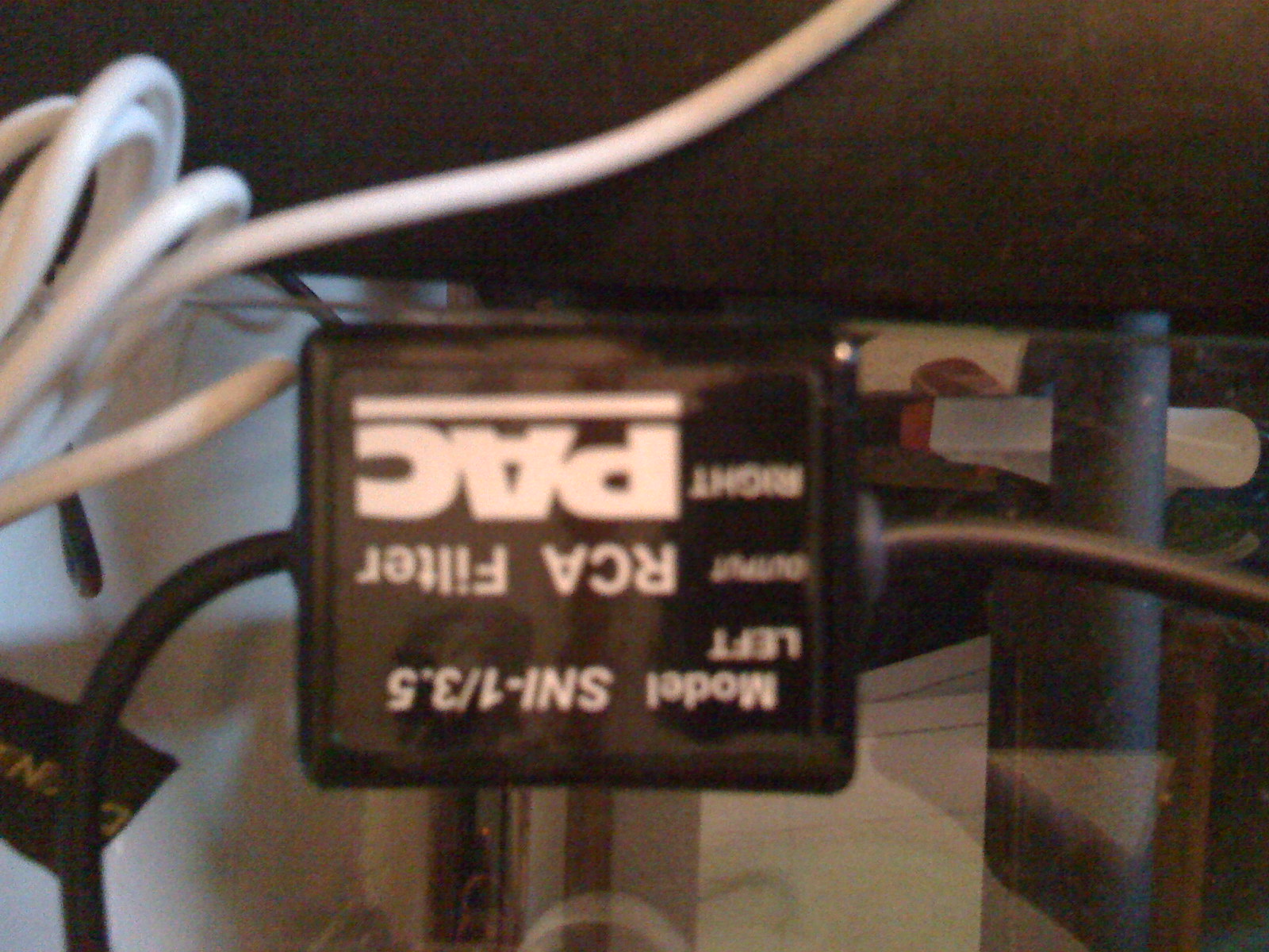

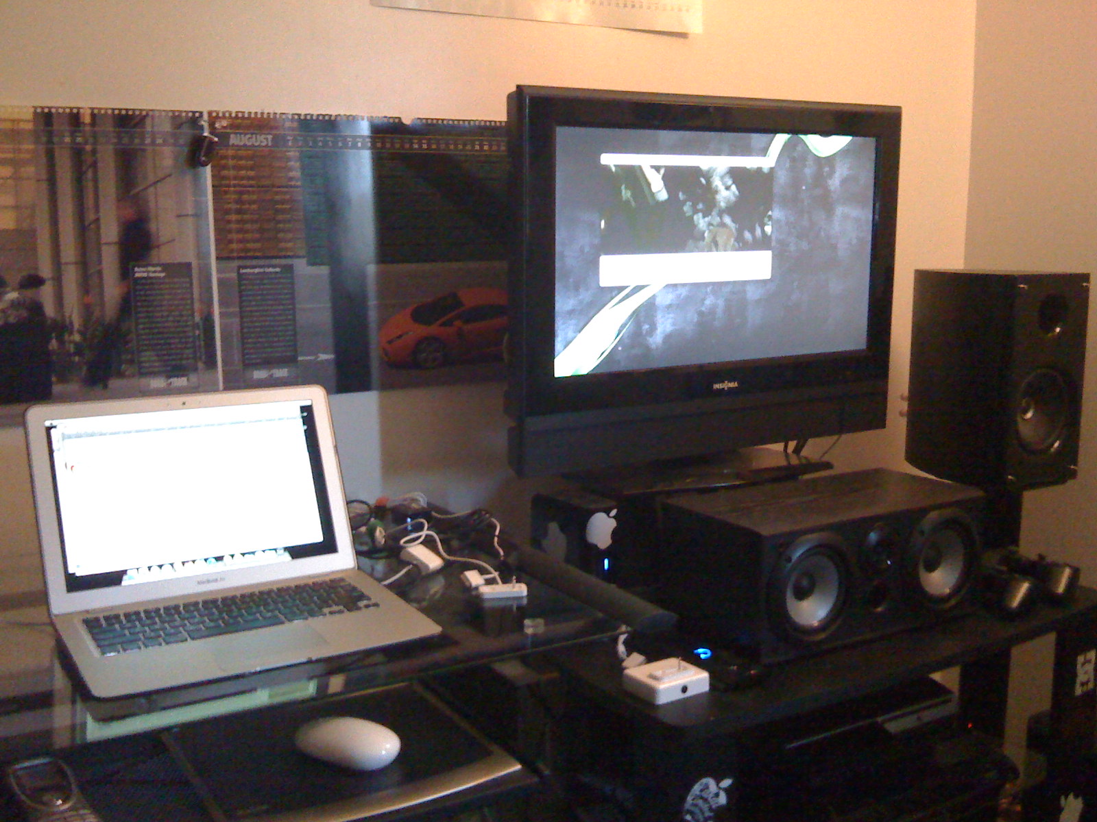

I am an audiophile and i use my macbook air to play my itunes through my audio system. I too noticed the high freq ringing. After disassembling my air thinking it was a hardware problem i realized exactly what you think is true.... it is the video signal not shielded well enough from the video and jumping to the audio output. I did however find a fix.... it will cost you about 20 bucks and is designed for car audio.
Pac SNI-1/3.5 Noise Filter
http://www.crutchfield.com/p_127SNI135/PAC-SNI-1-3-5-Noise-Filter.html?tp=1282&tab=review
I have tested it and the signal loss is VERY minimal. (less than a db at most frequencies)
