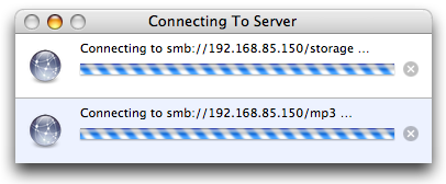

I've had an issue a few times recently where after connection to an SMB share the connecting to server dialogue box with progress bar does not disappear after connection.
It's fine with all our X-Serve share points, just the XP based SMB shares.
I have both a Mac and a PC in front of me at work and often connect to the PC to copy files over etc.. and will sometimes connect to 5 or 6 different shares in a day.
Obviously not ideal to have a 6 connection deep progress bar on my screen.
it doesn't seem to affect the connections at all but is an annoyance.
Any idea what causes this or how I can get rid of the progress bars?

I also have the same problem...
It doesn't seem to be a constant issue though only every now and then still very annoying though...
The only way I can clear it is to force quit the finder...
Does anyone have an idea as to the specific process the Connect To Server window associates?
I opened up the Console and watched for any hints to this problem...
I found the following error was constant when I could reproduce the progress bar remaining and it closing correctly.
Code:
mount_smbfs: spnego blob2principal error 1
I assume that since the error is the same regardless of the progress bar error it is unrelated...however I can't be sure.
Additional points which might be helpful:
  • The error occurred right after I resumed from SLEEP (Opened my PowerBook)
  • The errors are not reproducible after a Finder Force Quit
  • Mac OS X 10.4.11
  • Connecting to Samba Share on Fedora Linux Distro
  • Share always mounts successfully regardless of Progress Bar completing
