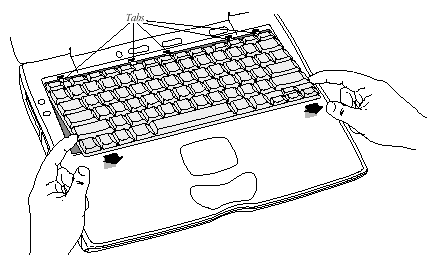

you should be able to lift out the keyboard by pushing in the keyboard tabs up at the top of the keyboard, above the F-function keys. be careful not to pull it off too hard their is a paper thin connection cable on the back. the tiny set screw at the top is likely unlocked, but if not you'll need a small slotted screwdriver (like a jewellry set) to turn it.
just flip the keyboard out give it a wipe have a look around see any of the beer is inside. you're probably alright, although your keys maybe a bit sticky after.

carletonmusic said:
maybe I'm not looking hard enough for my "tabs". Are they in the same place for a 17" PB?
Thats for an older PowerBook. I don't think they are actually there on the new(er) ones.
