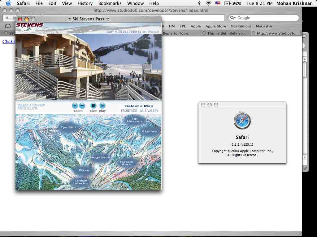

studio360 said:
I've had a heck of a time finding a good forum to ask this question. We have a pop-up window that
has frames and a map loads in the bottom frame.
Its works on every browser except safari. On safari we get no map and a white margin on left. Anybody know what gives?
http://www.studio360.com/developer/Stevens/index.html
I know a bunch of other people answered you with fix suggestions, but I just wanted to throw in, that it seems to work correctly for me in Safari. I don't see any white margins. See the attached picture -- isn't this what I'm supposed to see? Clicking on locations on the map also changes the view in the 360 frame. I have an iBook G4 of December '03 vintage, and Safari 1.2.1.
The problem lies now rest with IE once I updated the code for Safari IE began giving me this problem. when selecting the Mill Valley map we're getting a double header that pops up in IE.
