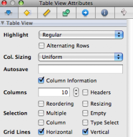

So, the first experiment is to simply drag in an NSTableView and set the columns to 10.
Here is the screenshot. (cropped to save space)
with these attributes:
And this the console.

If I set the column widths, say to 750 Max Width, the console shows this ( I wont' show it ...but it does) and the screen shot is ( first expanded..the last columns do show uniform width)
and *compressed*
So, not sure what to make of this...I was able to get it to be uniform once, but now cannot get back to that, but the same issue happened. As the window was made narrower, at some point the first 1 or 2 columns ( cannot now recall) stopped becoming narrower and the uniform width was compromised.
Thanks for helping.
If you click a column in IB you can prevent it from resizing. You also may want to set the minWidth as well.
If you want equal widths all the time, you need to first set it up in IB like this, and then set Uniform.
I'd also suggest reading the different NSTableViewColumnAutoresizingStyle values in the docs so you know what those are doing.
