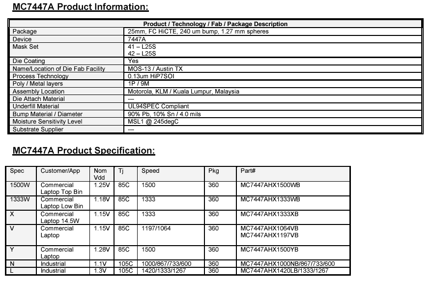

Looking at the MC7447A Rev 1.1/1.1.1 Qualification Report (pdf) I'd almost be able to say, "Yes they are 7447As."
Since the spec for the 1.33 and 1.5GHz chips are usually the ones Apple's used in the portables in the past -- the W spec series.
But I also haven't seen a part number for laptops since they swith from the XC74... to the newer part numbering scheme MC74...
