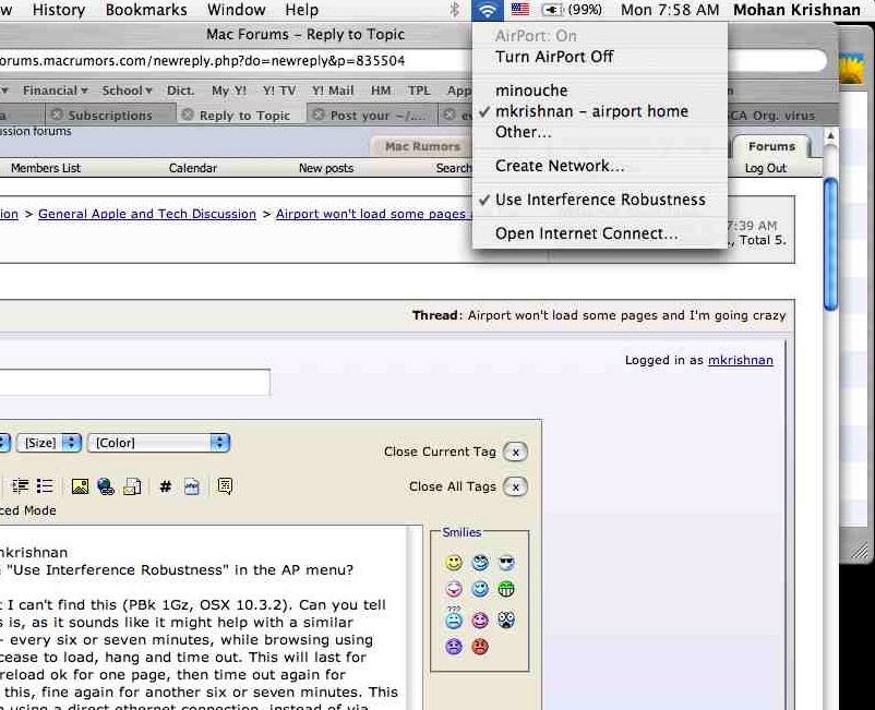

Did you try turning on "Use Interference Robustness" in the AP menu?

Quote:
Sorry to be dumb, but I can't find this (PBk 1Gz, OSX 10.3.2). Can you tell me exactly where this is, as it sounds like it might help with a similar problem I am having - every six or seven minutes, while browsing using Safari, all pages will cease to load, hang and time out. This will last for about a minute, then reload ok for one page, then time out again for another minute. After this, fine again for another six or seven minutes. This does not happen when using a direct ethernet connection, instead of via Airport. Any ideas?
As far as the interference robustness thing, please see the attached picture. This has been in all versions of 10.3 AFAIK. Dunno if airport (non-extreme) has it though. It's supposed to help if you have a lot of interfering devices like BT or cell phones etc putting out 2.3 GHz signals or noise. But no one seems to know exactly what it does.
How far away from the base station are you? Have you tried to see if it happens when you are sitting two feet from the station, but still wireless?
