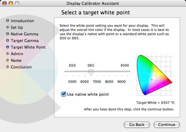

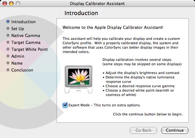

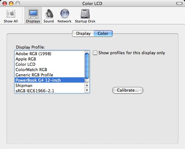

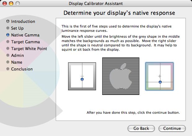

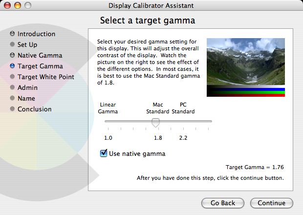

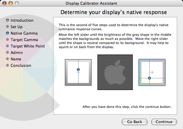

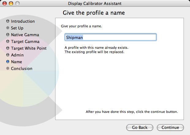

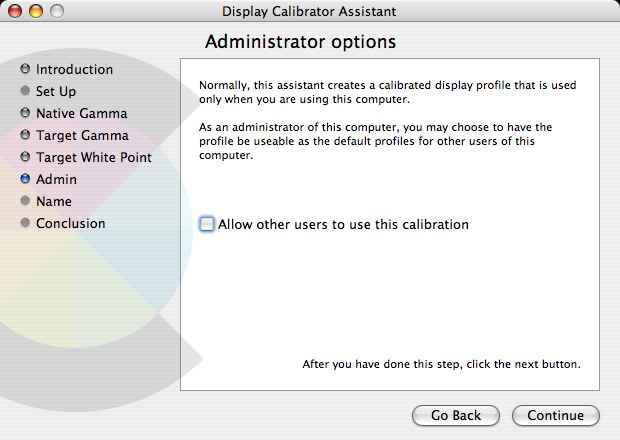

Open System Preferences>Displays (Option+F14) and then click color. Then click Calibrate. It will save as an ICC profile in your ~/Library/ColorSync/Profiles folder. If you have a good printer you might want to switch the profile your printer uses with the same one using ColorSync Utility in the Applications/Utilities folder. Though Photoshop has a US. Prepress Defaults option where the RGB is Adobe 1998 and the CMYK is the US Web Coated (SWOP). If you're printing don't forget to make it CYMK. Good Luck!

I did calibrate my Powerbook, but it always seemed cold for some reason. I searched the web and Simon Brown had a nice 12" PowerBook ICC profile that looks decent on my 15". However, the best option is always a hardware solution.
If the Calibrate window doesn't come up, I suggest removing supercal? It might prevent Apple calibration to work. Dunno, as I've never used supercal.
Hmmmm as I typed this that Simon Brown profile started giving me a headache so I went back to my profile. Oh well. If you think you'd have any luck with it, here's the link. Usually if you can embed your printer's CMYK profile they can usually handle it. Photoshop says Euroscale Coated v2 is Europe's Prepress Default for CMYK, but you might want to get someone's option from the UK since I dunno if they follow European standards.
