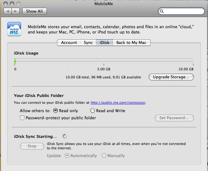

I went to my MM sync preferences and clicked on iDisk.
I uploaded a test document and time stamped it. After it syncs for the first time (I had it off) then I'll report back and let you know.
I am actually almost thinking this does do what you want it to but I have to try it out first.

Okay, I've tested this and it DOES sync. However, like any sync program I think you need to be saving your numbers document to the iDisk app from the beginning.
You see, if MM is set to sync it has to know what to sync. Do you honestly want it to sync your entire Documents folder? I certainly do not. There is so much junk in there it is stupid.
Now, I made a text document and saved straight to my iDisk folder. I did NOT need to be online when I did that. I set my preferences (ABOVE) to allow me to access that folder when I am not online. I turned off my wireless internet and went to work. I updated. Once I turned the network back on it automatically sync'd because I told it to automatically sync (see above). Therefore, the second it sync'd all of my changes were made!
