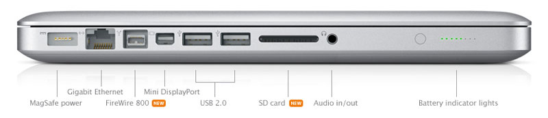

The new MacBook Pro has Firewire (FW) 800 with a 9-pin port.

Also the ports on the new MacBook Pro 13-inch:
