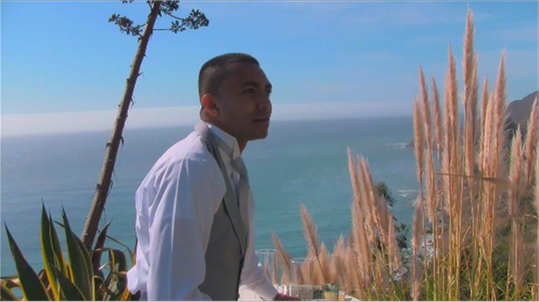

I shot this wedding in Big Sur with a Canon Vixia HF20 camera and got nothing but hard shadows in the foreground even when I would put my back to the sun. I've tried some basic changes with the 3-way color corrector in Final Cut 7, but it really washes out the entire picture.
1. Any tips on how to possible fix the shot so we can see his face?
2. How do I avoid this in the future? I tried many different modes, nothing seemed to fix it.
What setting would you guys use to fix the foreground?
Best,
DD
Can you do a frame grab of the video and post a still?(I must have posted before your upload) That way we know exactly what your seeing and can offer suggestions for correction.

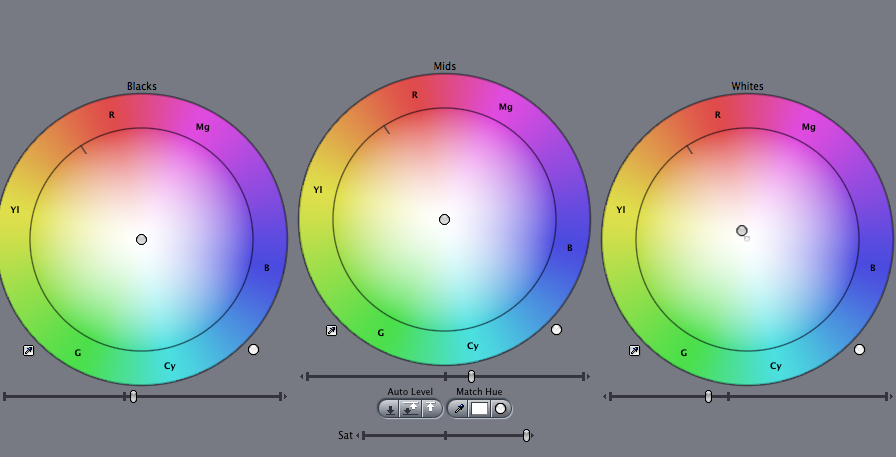

This is something I did real fast w/the 3-way CC in FCP. His face is a bit noisy and how well this much of a change will hold up on a moving image I'm not sure, but you can always hit "undo", right?
High contrast conditions like this are hard to shoot in especially w/consumer cameras that don't have very good dynamic range. If you can get a neutral density filter that can help or a bounce board (as someone else mentioned) but that's not really viable for an event like a wedding, and a tiny, on-camera light has no chance to compete w/the sun. Another option is to buy a nicer camera that has better dynamic range. Ultimately you have to expose for your subject even if that means losing other parts of the image. Is seeing the guy's face more or less important than seeing the sky?

Thanks Lethal for posting that. I noticed when I would tilt down to the Grooms hands that it would adjust nicely and the range looked perfect. What setting in the Canon or any other camera would have to be played with so that the camera focus' on the face and not the background? This is the first time I've had to deal with these circumstances and the first time I've used this camera.
I normally shoot with a Sony Z1U but the client wanted a cheap deal so I brought my smaller camera.
So what do I have to adjust in the settings on the Canon or Z1U so that the camera focus' on the face and not the background.
There's not really a mode or setting to tell the camera "Hey, expose for this person's face" and have the camera track that person's face and adjust the exposure on the fly. You need to pay attention to the area you want to properly expose (zebras are great for this) and adjust exposure manually as needed. Of course the down side to consumer cameras (and to a lesser extent 99% of prosumer cameras) is that adjusting settings on the fly is not easy. It something that takes practice as well as being familiar w/your camera so you can learn how "wiggle room" you have w/regards to exposure and manipulating the image after the fact in your NLE.
