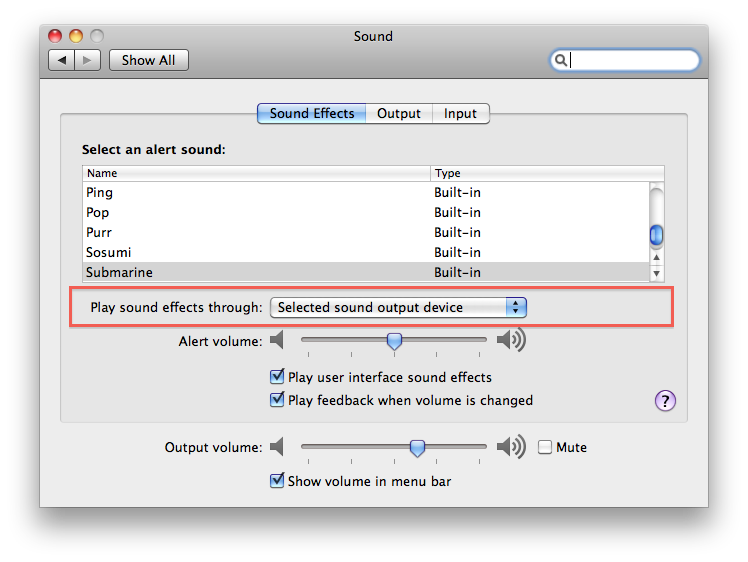

After updating to 10.6.2 on my Mac Pro, iChat sounds ONLY come out my internal speaker. All other sounds come through line-out with no problems. I also checked my iChat preferences and made sure I had "Line Out" selected in Audio/Video.
I've restarted a few times and changed System Sound settings and I cannot get my iChat sounds to come out of my line out (external speakers). Like I said, all other apps and sounds are coming out line out like before.
I think it must be an iChat specific problem. I even tried trashing the iChat preference file and that didn't work.
Does anyone have a fix for this? It's driving me up the wall. I never had a problem before 10.6.2.
In the sound preferences of system preferences, under sound effects, where does it say "play sound effects through?" If it says internal speakers, then it will always play through there even if your output is selected as line out or USB speakers.

By the way... I saw those threads but it didn't say anything about iChat. The only useful response I've found so far is the reply just above yours. Thank you Southerndoc! I'll have to try that when I get home. I didn't realize there was a separate setting for which speaker set to play sound effects through. I guess iChat sounds can be called Sound Effects but I didn't realize iChat sounds were affected by the Sound Effects preference pane. Again, thank you for your helpful reply.
Thank you! That makes an incredible amount of sense now. I always have alert sounds turned off so that would be why I didn't notice if ALL sound effects were coming out my internal speakers. Also, 10.6.2 changed all of my sound settings for some reason, while I fixed Sound In and Sound Out, I didn't check my Sound Effects settings.

Just wanted to confirm what southerndoc had said.
iChat's sounds are tied to the "sound effects" option in Sound Preferences. I just tested this.
Make sure that is not set to Internal Speaker.

Glad I could help. I stumbled on the setting a while ago. I actually send iChat sounds to the internal speakers and regular sound to my Bose USB speakers. When listening to iTunes, I could barely hear the notification sounds of iChat. Now I send them to the internal speakers with the volume cranked up. Sometimes the volume settings get reset though. Guess it's just a bug.
