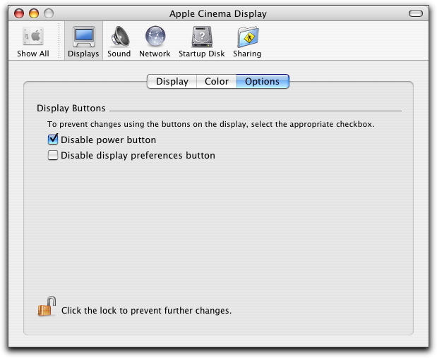

It might have been mentioned in the links above (didn't see it, but didn't read them completely), but my G5 had the exact same problem. In my case, though, it turned out to be my 20" ACD. When I disabled the ability to use the display's power and brightness buttons (System Preferences..., then option-shift-click on Displays, go to Options, disable buttons), it all worked again. Yes, I have AppleCare, and yes, they sent me a box to return the monitor in, but i've opted to deal with this for now (never used the buttons anyway) as opposed to being without a monitor for weeks.
If you have an ACD, this might be of help to you.
BTW, while verifying this, I noticed that - new to 10.3.5 - you can disable the power and display properties buttons independently. As of 10.3.4 and earlier, they were combined.

Buttons?
I have a 20" ACD. Single Processor 1.8.
Installed 10.3.5. Doesn't exactly sleep anymore, but the display is off.
I never knew that those are actually buttons on the display !
There are kinda cool. Any more "hidden" buttons?
