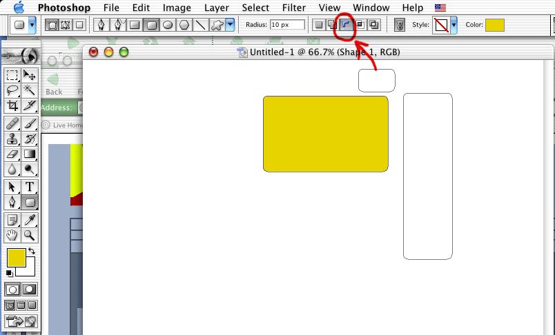

ok, i just had a look and here's what you do:
selsct the shape tool and then go to the tool bar thats along the top. now in the group of buttons that are in the middle you have to have selected 'Subtract from shape area'. now you can draw with just the line! hope that helps, the screenshot should clear things up.
