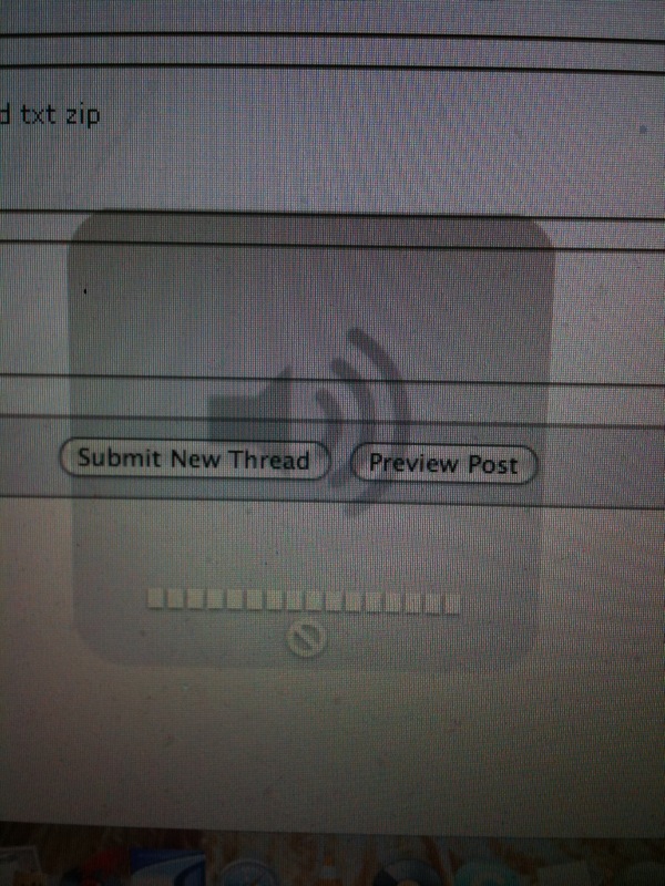

ok the other day i opened my mac book and i couldnt listen to my music
through my speaks
and i tried to turn up the music cuz maybe it was on mute
but i got a pic like this
(If u cant see it but its the speaker up full volume and the not allowed symbol the circle w/ the line through it)
and then i discovered that there is a red light coming out from speaker jack
and i could only use my sound through headphones or a jack through other speakers (like a sound system) but no only that i can only hear through the right side of the headphones unless i hold the cord a certain way
someone plz help i need every advice possible and as soon as possible cuz i do dj with my mac too

Your Mac just got stuck sending audio via digital out. Here is one way you might fix it: http://leerodrigues.com/mac-tricks/m...tal-out-stuck/

To the OP I think I have read that inside the Jack is a little tab that tells it if audio is plugged in and routes sound through the headphone port. If you check sound settings I believe there is an option to choose to send sound out as speakers, digital or headphones. I have seen the setting somewhere on my MacBook. I have heard of some trying to free up that little tab with like a toothpick or inserting and removing headphone plugs.
To the second poster. Same may apply to you.

If you see a red light and no audio comes out, but when you plug headphones in, the headphones work fine, cleaning the audio-out jack often helps.
However, because you describe that you have to apply pressure to the headphones in order to get both channels of audio, it's safe to say that the main logic board (the part that includes the audio jack) is damaged. You need a main logic board repair, which almost always costs $280, parts and labor included.
An economical alternative would be to purchase a USB audio device (like the Griffin iMic), which is significantly less pricey than a main logic board.
Hope this helps!
