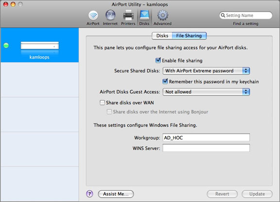

Have you configured Disks in AirPort Utility?
Here is a guide.
