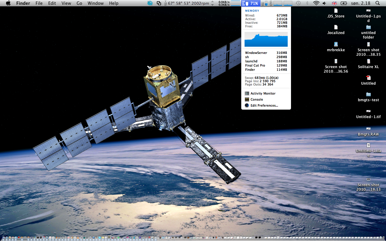

here is a picture of mine when just after the fans went back down to around 2k
Maxed out everything opening all my apps at ones while running Matlab and Cinema4D doing rendering.
Max temp i got was 96 dg celsius and fans spinning at 5700.
