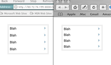

I have a strange problem with a very simple CSS menu I built in IE5/Mac. I would appreciate it if someone who is a IE/Mac/CSS specialist could take a look and help me out. The code is really very simple and I have no idea what confuses IE so much 😕
The menu works just fine on all Windows, Linux browsers and Safari but IE5 produces weird effect. Here is the link- http://80.72.74.155:8000/sample1.html
And here's how it looks in IE 5.2.3 and Safari 1.2:
Thank you in advance! 🙂

s_ivan10 said:
Yvan256, I know it's better to use lists for the links but I had some very nasty problems with them on IE5/Win and that's why I decided to not use list in the case. Thanks for the suggestion, anyway! 🙂
zim, thank you very much! 🙂 Does this look OK in IE5/Mac? Unfortunately I don't have a Mac here and can't test it on my own 🙁 And also I would really appreciate it if someone could make the original structure work on IE (just by modifying the CSS). I know it's not very clean (especially with those DIVs around the A elements 😉) but I have my reasons to use exactly this markup.
I suppose the main problem in my case is coming from the fact that I MUST use relative positioning for the A elements. And this probably confuses IE.
PS: I corrected the closing tag for the toolbarHolder div. Thanks for noting it! 🙂
Yes, the modifications that I made work on the Mac.
Here is the answer to your problem, within your markup:

If you take out position: absolute; top: 6px; from your .subindicator class then IE Mac will render it fine. You could also due away with the overflow: hidden; for it does not appear to be doing anything.

Anyway, could you please take a last look. 😱 I put the span out of the A element and I now have the strange feeling it will work in IE (although I made the code even more complex). Thank you and sorry for bothering you again! I promise to not do it anymore! 🙂

I attached a preview for you, comparing ie to safari. There is a size difference, other then that they work fine.

A final THANK YOU, zim! 🙂 You saved my life! 😉
I definitely can live with the size difference.
