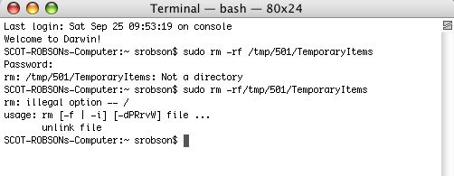

I'm trying to install 2 updates.
Java 1.4.2 Update 2 and Security Update 2004-09-16
below is a screen shot of the error message i'm getting. My mac seems to be playing up a lot at the moment I am also having this problem -https://forums.macrumors.com/showthread.php?p=1049576#post1049576 - but im not sure if they are related.
Hope someone can help. - I have repaired permissions.

Ok, I tried that twice, wasnt sure of the spacing. Where did I go wrong?
EDIT: Hold it, the first time it went though be it didn't find the file directory, give me a second
Second Edit: put a final slash / at the end so it ends "TemporaryItems/", and yes, there is a space like you did the first time. I'm still looking into the problem, because I dont know if that will fix anything
if you get an error that it doesn't exist. Do a change directory to it. "cd" then path to directory with no options like the -rf. see if it is even there.

Tried with / at the end and got the same "Not a directory"
Yeah it doesn't matter if the final slash is there or not. Please post the results of:
ls -laF /tmp/501

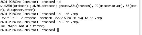

they look like the letter L (ell) - this is what i got
Edit realised i missed a slash out - tried again and that came back with Not a directory

Came back with Not a directory for both of these options!

Let's start from the top then. Give us the results of these:
id
ls -laF /tmp
ls -laF /tmp/

Actually, "His: drwxr-xr-x 3 yellow wheel 102B 25 Sep 08:34 ./" is mine. I don't know why your /tmp/501 directory is so closed off. That makes it hard for the OS to write to your tmp directory 😉
This is obviously Panther, but that's not right. Not right at all.
Your /tmp directory should be a symbolic link to /private/tmp.
Code:
yellow% ls -laF /tmp
lrwxr-xr-x  1 root  admin  11 11 Aug 20:36 /tmp@ -> private/tmp
You will notice that your /tmp is a FILE (and a very large one at that (827MB!)), not a directory! This should cause alarm! Please give us the output of:
file /tmp
For future reference, just copy from the terminal and paste into the code tags, no need for screenshots and attaching things. Thanks.

Never thought of copy paste lol
SCOT-ROBSONs-Computer:~ srobson$ file /tmp
/tmp: data
