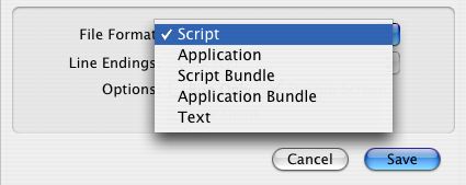

Instead of do script "./start_mysql.sh" use do shell script "cd CommandDirectory; ./start_mysql.sh" where CommandDirectory is the directory in which the command is located.
You may save the script as an application, as well as, a script. Save it as both since you can't edit it as an application.
