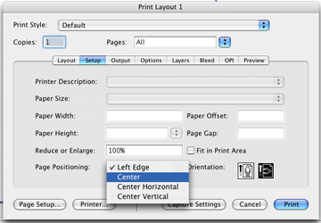

anyway - back to Quark - I'm sure you know this already, but the print dialog has a center option in it (attached pic) which I'm sure you know about, but maybe forgot? depends on how far 'out of center' your print is.
<edit> I went back a re-read your post, and yep, you're set up right - it's probably the driver interpreting info from Quark</edit>
