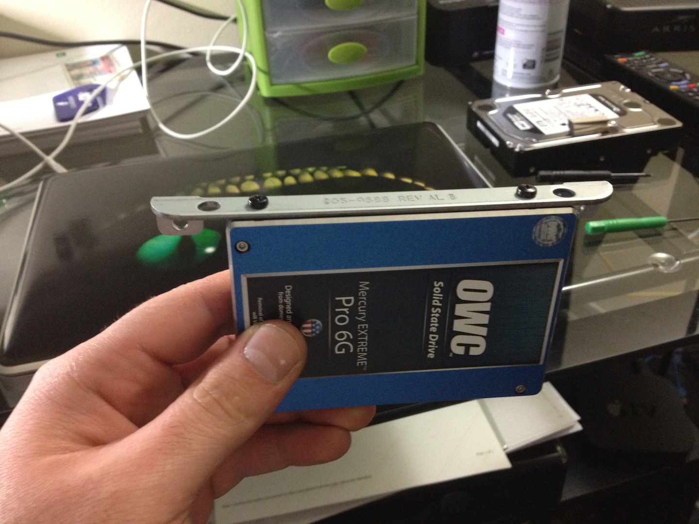

From what I understand.... and experience for myself.
In the '09 iMac when I switched out the HDD for an SSD there was an extra wire that plugged into the stock HDD from the logic board, a wire other than power or data cable. This is the plug you could "short" together with a piece of wire to trick the machine into thinking it was still connected.
On the new '11 iMac I just installed an SSD into, this wire is no longer present.
Just download an install http://exirion.net/ssdfanctrl/Site/SSD_Fan_Control.html
it was made exactly for this reason. To quiet the fan down to a whispering 1,400-1,500 rpm.
I'm going to get ripped and laughed at or whatever.....but would someone please explain how to "short" the wire or the plug. I just changed my HD cause it failed on me to a SSD. I like how the machine is performing but the noise is driving me freaking crazy.
Just short out the HDD temperature sensor with a bit of wire. Works great. The sensor has two wires, you simply put a short length of wire across the header contacts and tape it up.
