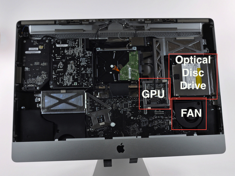

Thus it seems, the ODD fan is nearest to the GPU.
iFixIt TearDown of the 27" iMac

The gpu is on the right side of the iMac when it's facing you, so his picture is right.
The cpu of a computer will always be somewhere on the motherboard, while a dedicated gpu is usually has its own daughterboard and connected through some sort of pin interface-- in this case it's an mxm interface (mobile pci express)
The optical drive fan is directly below the gpu's heatsink, so in this case the odd fan will provide the best solution to cooling the gpu.
