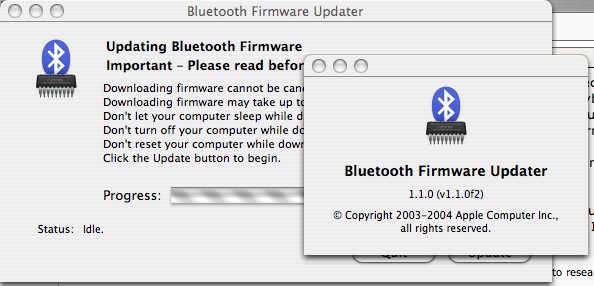

So, I came home and checked my ignored updates, and the only thing in there was an iSight update. I opened my BT Firmware Update program, and checked the version (below). Does this look right? What is the procedure I should be going through? I'm a little confused. 😕
No, the one that Apple just release is Bluetooth Firmware Updater version 1.2. Click here to download the latest version from Apple's website.
I have a feeling that I missed the last firmware update (1.1) for some reason (or downloaded the program and never ran it properly), which may explain why I had some problems and why my mouse has now gained "work from sleep" capability. This new 1.2 update should just improve reliability for you, although you may not notice a difference.
