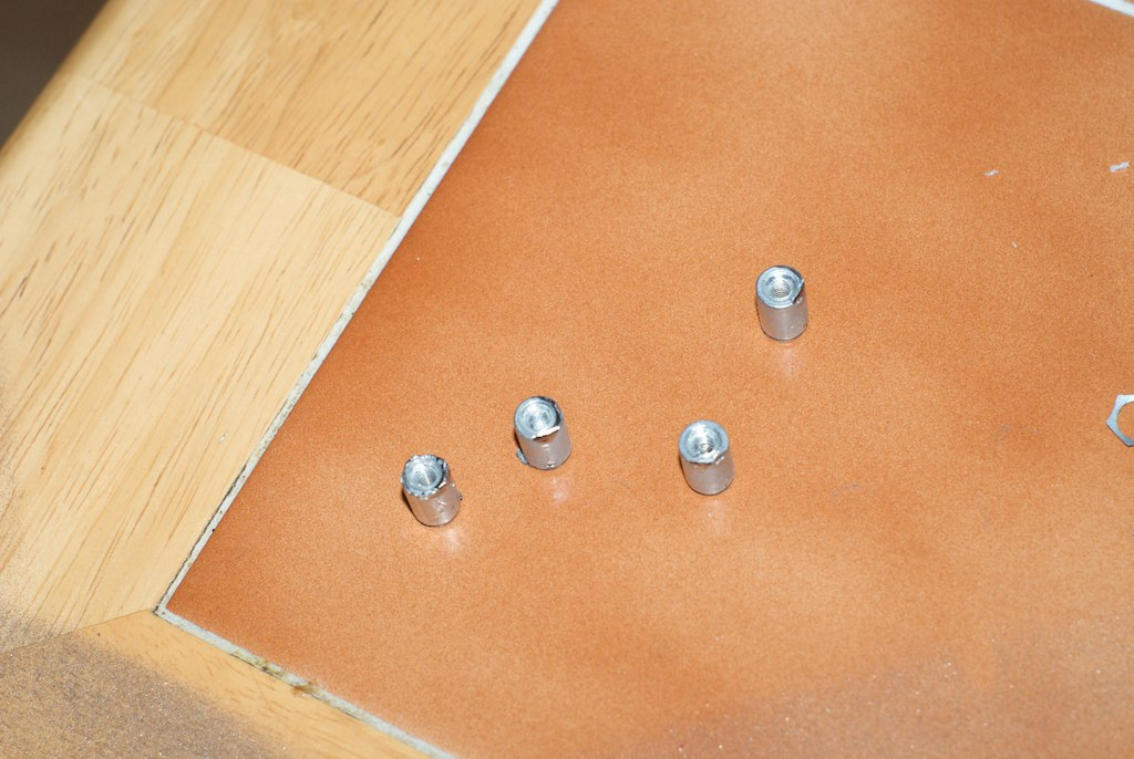

    Here are the offending standoffs
    [​IMG]

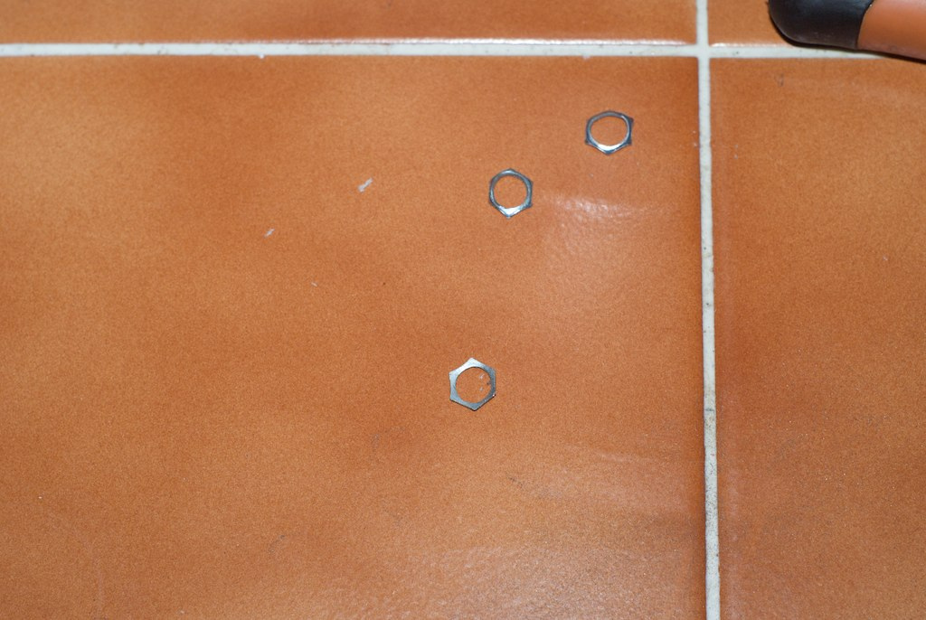

    These are what hold the standoffs in on the door, they should just fall out.

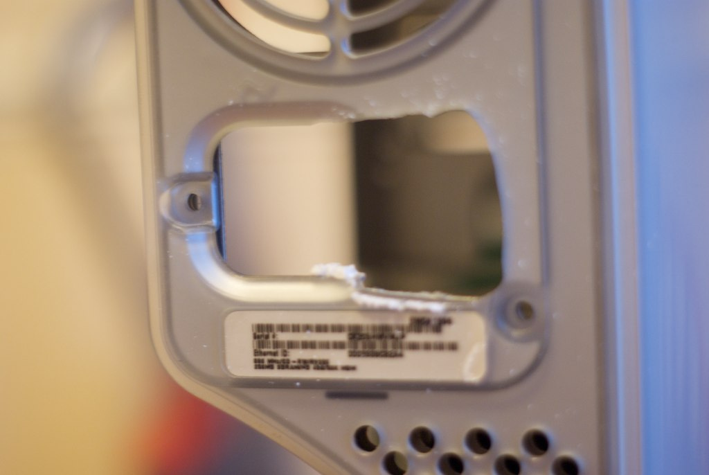

    My next stage is to get the back acrylic panel ready so I can plug power into my PowerHac, so with the new Dremel (well, it's a Draper) I got to work with a spinning diamond tipped thingy...
    A blurry picture after dremelling:
    [​IMG]
    With the PSU in place:

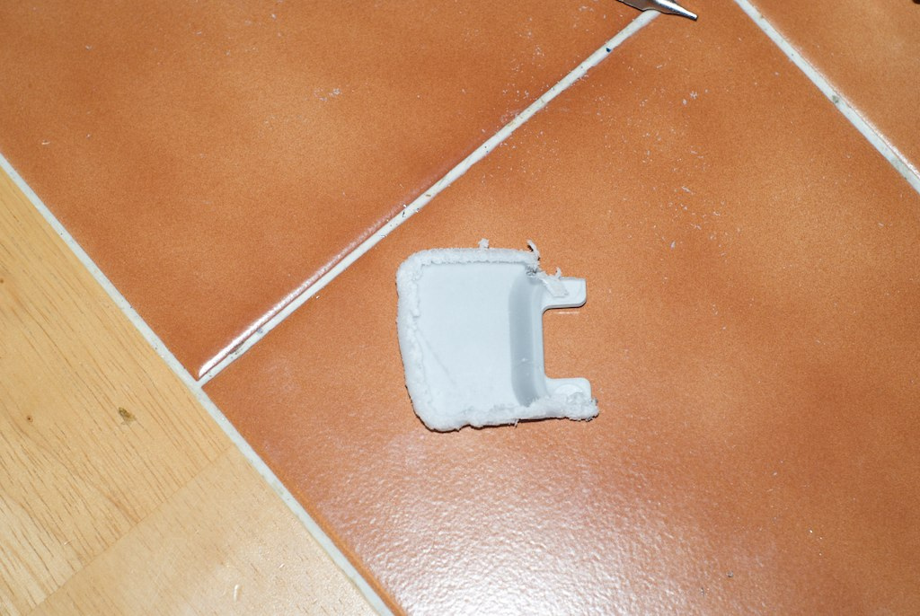

    This is the piece which wasn't required:

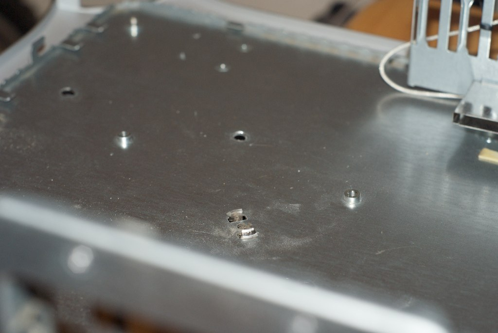

    With the PSU ready, the next step is to cut a large chunk of the backplane out. You need to keep the expansion slots, so drilling the rivets out would be an arduous and possibly counter productive thing to do. I set with my Dremel and at first a diamond spike which worked a treat on plastic, but only goes about a mm on metal. I then fitted a cutting disc, I managed to get halfway along here and the disc had gone to about a quarter of it's original size:
    [​IMG]
    I then took another disc, it split and got caught between holes, but the next one, I eased in and it got past the end of the vent holes towards the left of the picture above and then i put too much pressure on it and it shattered too.
    I've stopped for tonight as I have some more discs on order, which should be more hard wearing for this metal.
