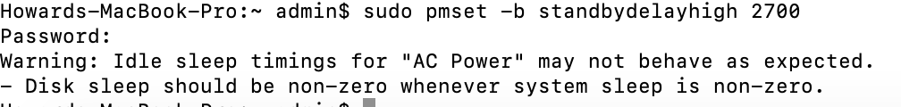

Your standbydelayhigh is set to 24 hours. *If* you ran the command while on battery power, this explains why you lose so much overnight- the machine is never going to full sleep.
sudo pmset -b standbydelay SECONDS
(change seconds to something more fitting.) I set mine to half an hour.

I've set this for 30 minutes. Thanks for your help, I'll try it again over the next few weeks and see how it performs.
I don't need to be concerned about the AC Power message right?

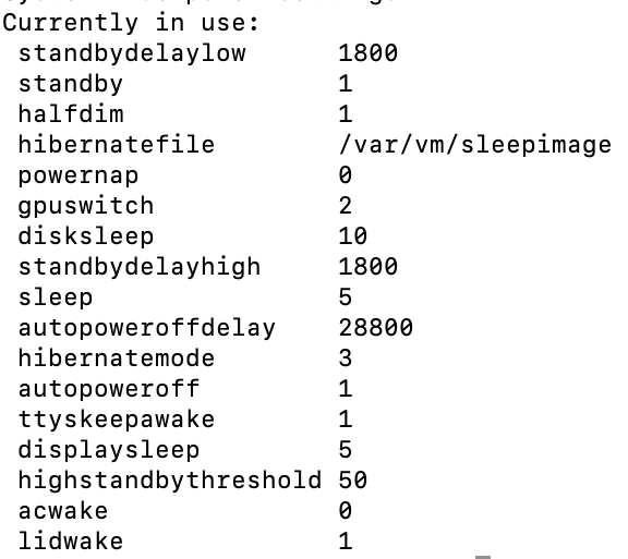

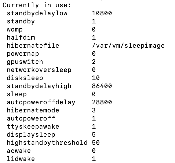

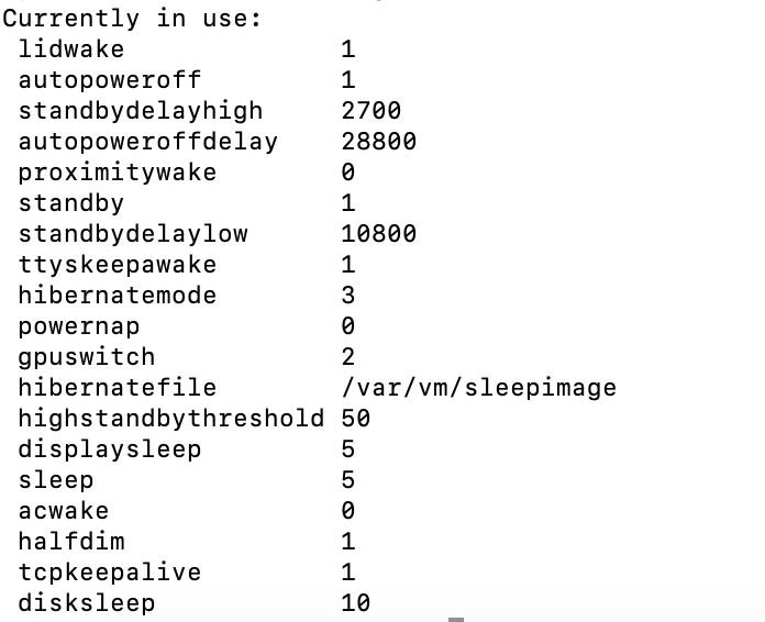

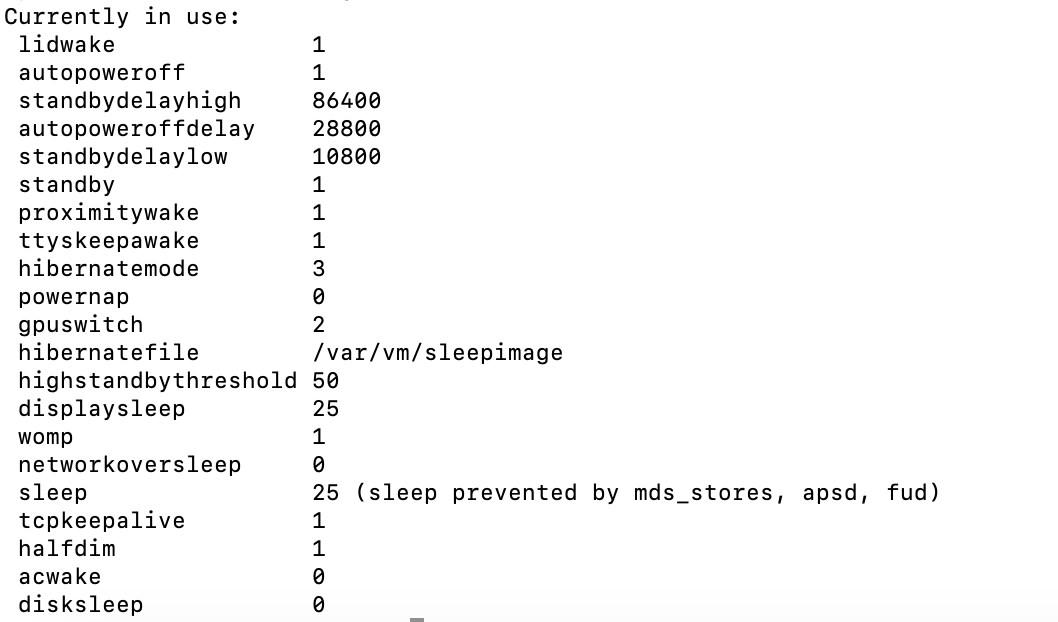

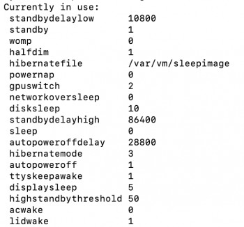

Current pmsettting on battery and on power.
Battery:
Power:
