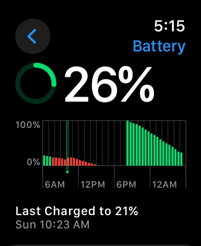

What did your battery graph look like? I’m having the problem that sometimes after I charge the watch to 100%, it will rapidly discharge and when I check the battery graph it isn’t showing anything.
This is a S8 45mm SS and still on 9.6.2. This happened several times now and if I reboot the watch it stops and starts showing again in the battery graph.
In the graph where it isn’t showing, it discharged completely (I got low battery warning when I woke up and died shortly after). After recharging completely and rebooting it started showing again but even the charging isn’t showing, so it still needed a reboot.
@anodibu My battery graph looked like the first portion pf your graph, up until the disappeared part. That’s when I plugged back in, charged tofull and the problem repeated. Tried turning both the watch and phone off. When that didn’t work, I unpaired, turned both off, turned both on and re-paired. That worked.
No idea why.
