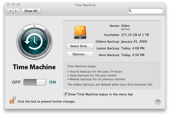

    Mines working just fine on 10a432 with a Maxtor 1TB drive connected to a Late 2007 Macbook running 10.5.8. I had issues with every build prior to 10a432 though. I did cheat though, I connected the drive directly to the MBP I'm backing up, and created the sparsebundle, ejected it, and then mounted it over the network.
    [​IMG]

    Cool orange icon. Where did you get it?
