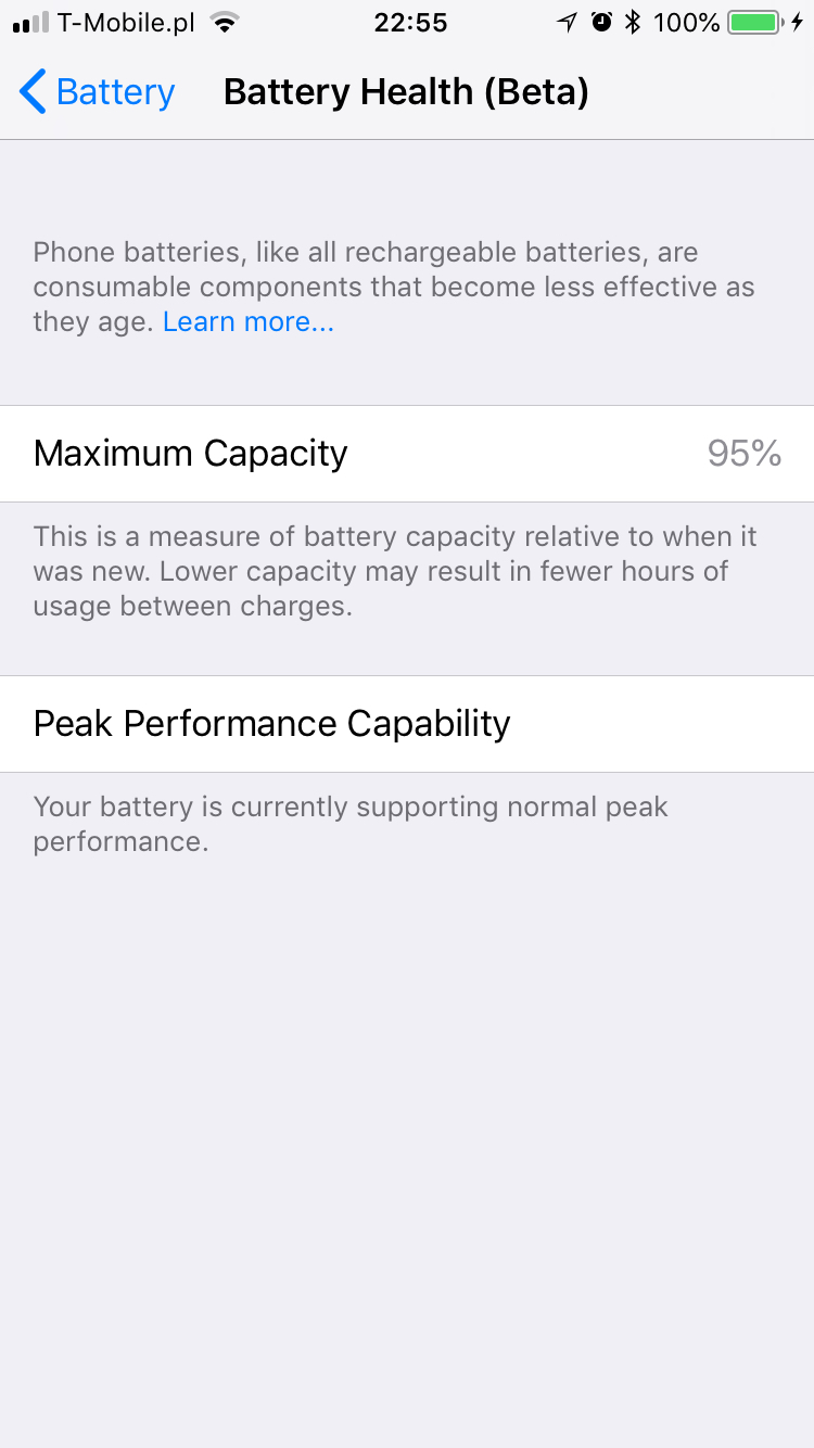

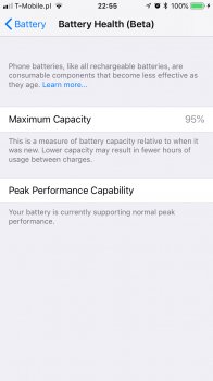

Battery health (beta) on my 6S shows 95%, which looks OK (the battery was replaced by apple for free about a year ago, as it was one of the affected units), but the Battery Life app, as well as Coconut Battery show that it's only about 83% (and it changes a lot day to day).
Is the iOS feature too optimistic, or are the third part apps erratic?
Coconut battery seems to be accurate. It shows within a couple of percent of the Apple battery data. Not sure why your results are so off though. I have no experience with the Battery life app..

One important thing to consider is that CoconutBattery is really only accurate for battery health when you are charged up to 100%. See if that makes a difference.

In addition to what the others wrote, be advised that the Battery Life app hasn't had access to iPhone hardware since iOS 10. On my phone the beta Battery Health function gives results very close to Coconut Battery. Battery Life is all over the place.

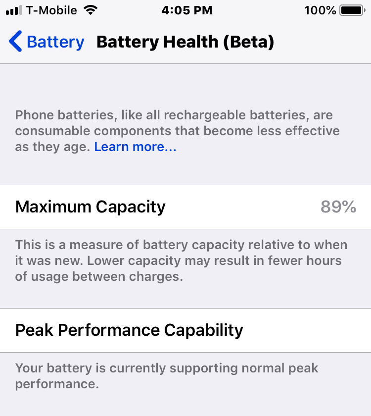

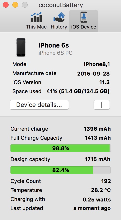

Here is my experience for reference.
CoconutBattery:
My 11.3 iPad mini doesn't display Battery Health (beta) at all so I assume the function in 11.3 relies upon some underlying hardware feature that is perhaps different to Coconut battery...

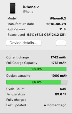

Interestingly, I'm seeing the same difference between coconutBattery (reporting about 78% max capacity) and iOS (reporting about 85% max capacity).
The other figure from coconutBattery (currentCharge) seems perfectly accurate against the device itself.
Somewhere I may have a USB charging meter. I guess I could near discharge the iPhone and see what that says (though I would expect that to over estimate somewhat as it is the power in and not the power retained....)
I think what Apple is showing is the max capacity of the battery when all conditions are at their best like say the battery is at room temperature and fully charged this is best number you can possibly get.
What coconut is showing is more detailed and is based off current capacity, charge cycles and current load and current temperature right at that time it checks it. That’s why it can change so much at different times and charge rates.
