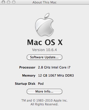

I thought 1333 mhz ram would under clock to 1066mhz in my late 09 iMac. However, on the system hardware screen it is showing up as 1333 mhz ram. What gives?

Yea its working. I'm just perplexed because everybody told me it would register as 1066mhz. Strange.

Are you certain that the logic board is 1066 and not really 1333?

RAM always runs at the slowest present speed I believe. So if all the RAM chips are upgraded to 1333MHz and you take out the 1066MHz bits everything will run at 1333MHz. But if you mix and match they SHOULD all run at 1066MHz. I think?

See the thing is though everything I read on hear said I could use 1333, but it would only run and register at 1066 because that is what the logic board was setup for.

No, 1333 can be detected, but there have been CAS latency issues with some people, so make sure you are using 1333 chips with the correct timings. Your safest bet is 1066 chips.

As of Intel Core CPUs the memory controller is integrated in CPU. That's why the chipset or logic board has nothing to do with memory speed/compatibility.
All intel CPU's support 1333 MHz memories.
I run 1333 MHz memories in my late2009 iMac too.
