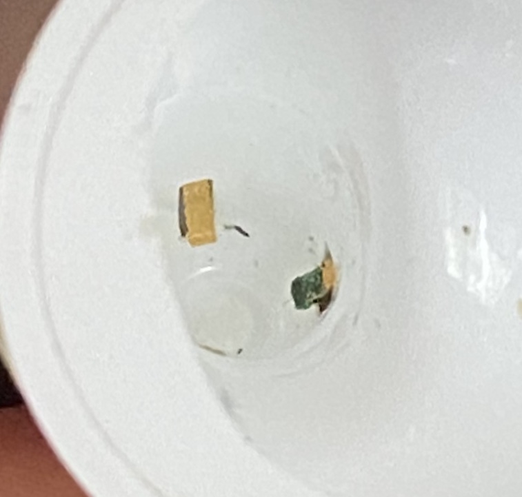

I had a problem with my left Airpod Pro not charging and the problem was the case. One of the pins wouldn’t make proper contact. Apple had to replace the case for me.
Here is what it looked like. Both should be gold colored but one of mine had a green coating. I think it came from Apple that way because I had problems with it from Day 1.
