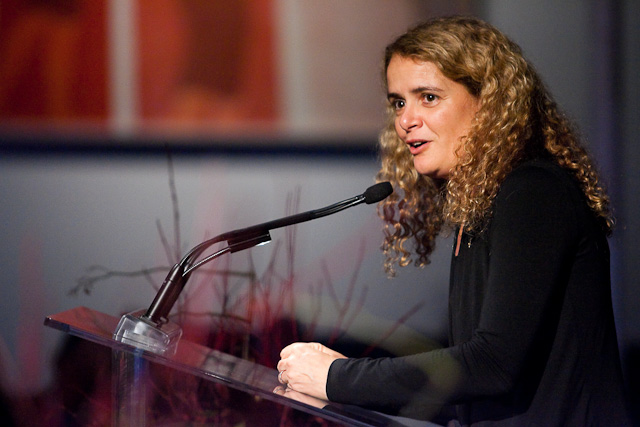

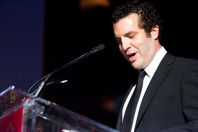

Attached are two (clickable) images I shot at a recent event here in Toronto (Canadians on the list will recognize the speakers as comedian Rick Mercer and astronaut Julie Payette). They're both shot with a 70-200 f/2.8L on a 1DmkII @ ISO 3200, 1/200s. Is there noise? Sure; especially in the shadows. And to be frank, it does not bother me in the least. And this is with a 6 year old camera with an 8MP sensor! I wouldn't choose this ISO if I could help it, and at 100% you can see quite a bit of pixel-level noise, but these photos are both featured on the client's website. And I wouldn't give up the AF performance of my 1DmkII just for a bit better high ISO performance.
The moral of the story? Pixel-level noise will inevitably increase as pixel density goes up; there's nothing much you can do about that. But I contend that unless you're making very large prints or have very, very picky clients, it's not really a big deal. There are far more important things to concern yourself with when it comes to taking a photograph.
