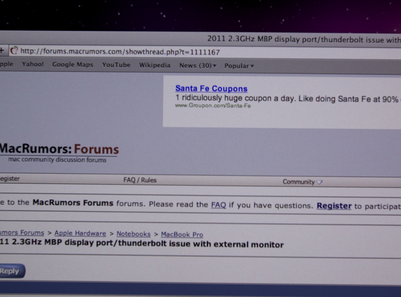

    have DELL U2410 - connected with display port cable (no adapters)
    Work fabulously with the 2010 MBP, today got the 2011 and i see ghosting around text, pixelated quality to it. looks terrible. anyone else experiencing similar ?

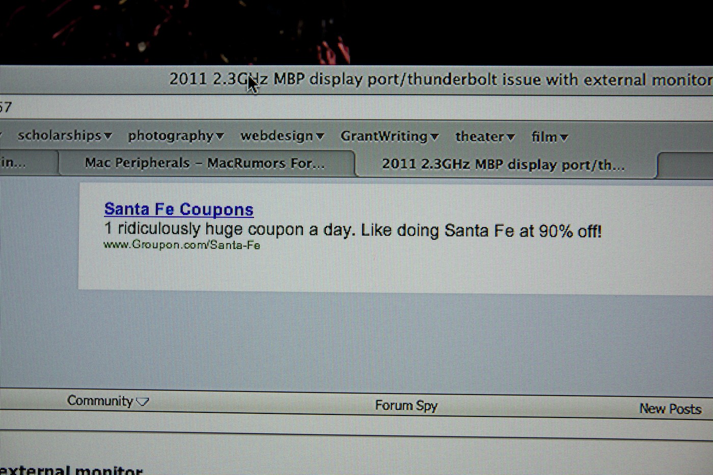

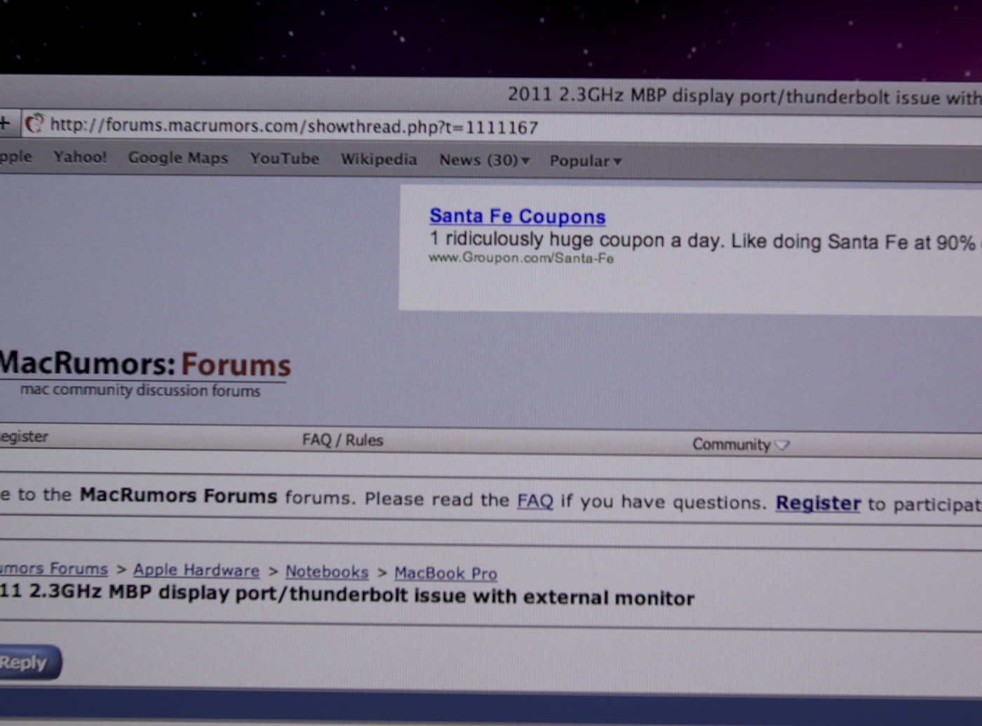

    tried the display reset. it's not major - but it just does't look right.
    i'm not paranoid, am i ? difficult to photograph this kind of stuff.
    ps: anybody has calibrated profile for U2410 on 2011 MBP ?

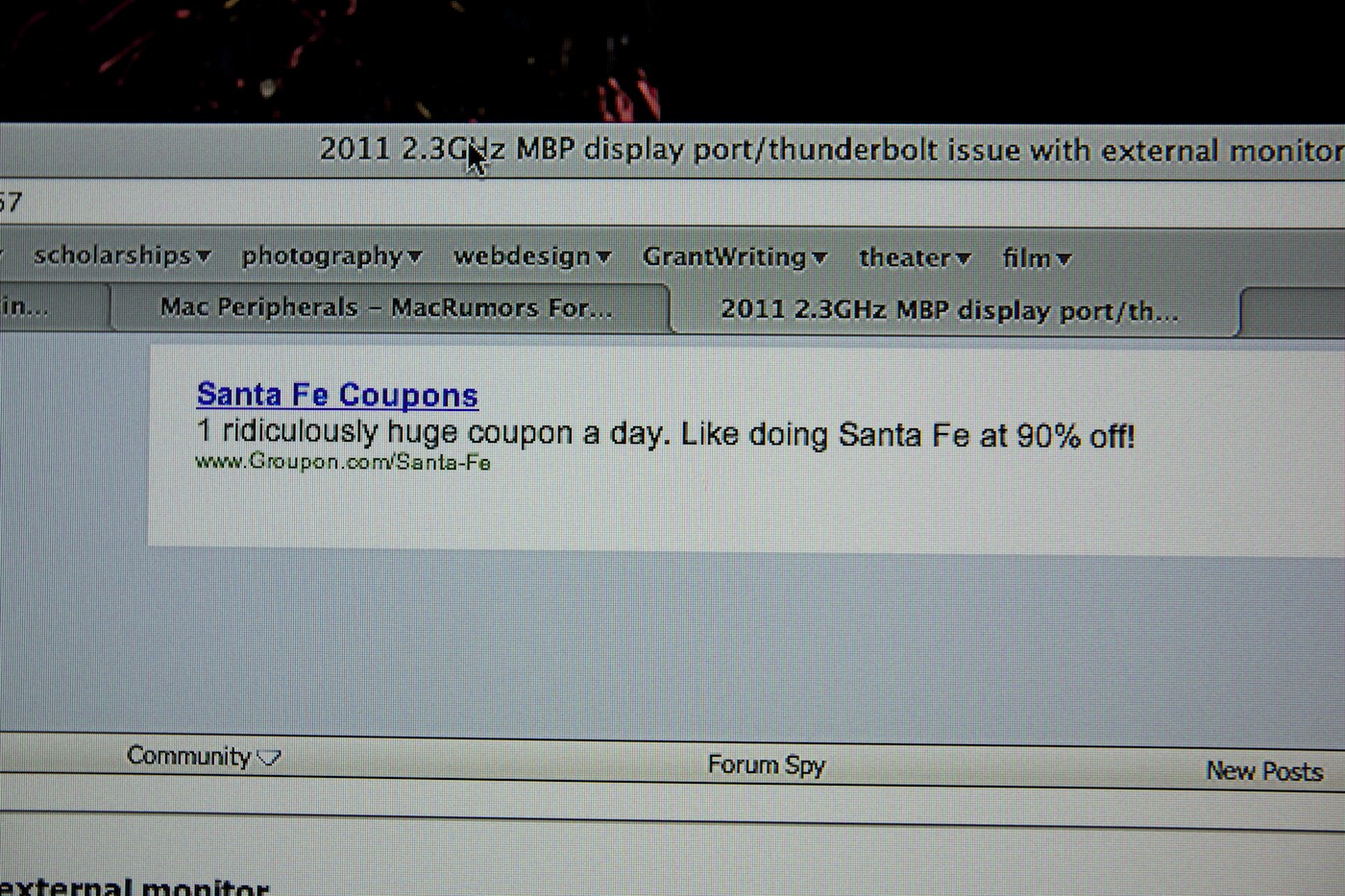

    just tested it on 2009 macbook - it seems i'm correct im my assumption - see the image.

    oh course i have it mainly for photo editing. i know my toys.
    1920x1200 @ 60Hz.
    tested on:
    2011 15" MBP (not right, weird halo & pixelation)
    2009 13" MB - nice and smooth
