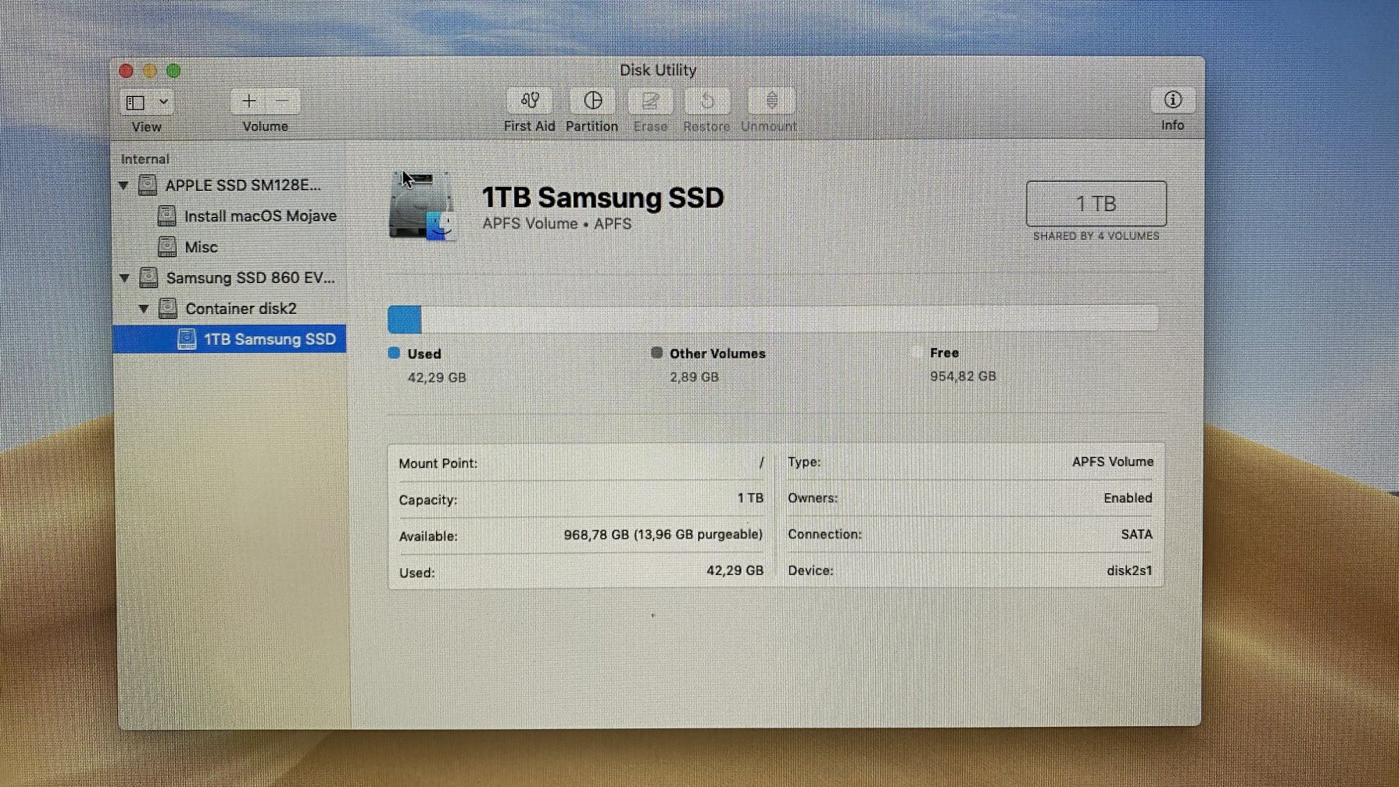

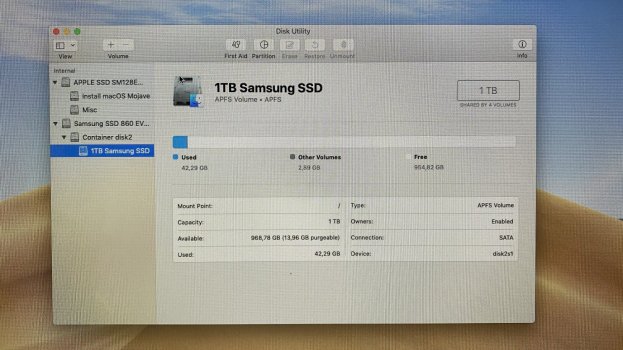

Ok, new SSD drive is installed and up and running. I did as you advised and created a 2nd boot drive on the 128GB SSD. Next job will be to reinstall data from Time Machine backup.
