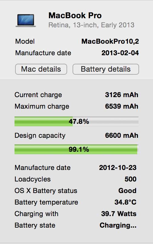

    I always read and hear people about not cycling their batteries so much because of the apparent "Degrading in battery life" but after a year and half and today reaching 500 Cycles on my 2013-Early Retina Macbook Pro, I cannot say those statements apply to the newer laptops....
    Perhaps iPhone batteries are also headed in this direction.
    I used to own a Macbook Air 2011 model, did the same thing, charged it daily for the almost 2 years, when I sold it, it had 88% battery capacity remaining and had approx. 800 Cycles on it.
    I charge my laptop daily because I use it for school and work all day just about.
    I have included a picture of my Coconut battery read (In the System Report under "About this Mac" it says the exact same info). I have always updated to the latest available updates when available. I Also charge my iPhone from my laptop almost daily because its easier to just plug it it to USB port than into the power outlet on my desk.
    When I took this picture my laptop was charging, but the two key points you want to note are:
    - Maximum Charge = The Maximum amount of charge it holds now
    - Design Capacity = The Design capacity of the battery
    One thing is certain, the # of charge cycles does not decrease the batteries capacity.
    This is the absolute best battery I have seen in any laptop I have owned and these are the Best laptops I have ever owned:
    - Gateway FX Series (Gaming laptop Early 2009)
    - Dell XPS (2010-2011)
    - Macbook Pro 15" (2011)
    - Macbook Air 13" (2011)
    - Macbook Pro Retina 13" (Early 2013) -- Current

    Doesn't change anything, charge cycles affect wear. As an easy counter proof, I had to change the battery of a 2011 MBA that suffered a catastrophic battery failure after 500 charges. And it too was charged daily.
    Do also remember that these batteries tend to have very little loss until their breaking point. You'll see very little difference until the battery reaches its breaking point, at which point each cycle will start to introduce significant capacity losses.
    You've also not cited the shipped capacity of the battery, in many cases its a bit higher than the design capacity. You should be doing a delta between that and your current capacity, not the design capacity and current capacity.
    That said, the bigger wear on the battery has always been heat exposure and deep discharges.
    And not charging daily does increase the likelihood of deep discharges, which are significantly more damaging.

    The Ship capacity was about 50 mAh above design capacity, being the nerd at times, I did look at that because I also monitored my Macbook Air's capacity from day one closely as well and I do this because I know that once the 1 year warranty runs out, I am on my own unless I pay for the additional warranty.
    My laptop has not had much hot environmental exposure because I always provide sufficient airflow between my lap and the laptop base usually by using a laptop pad thing i have and have only used it indoors.
    As for deep discharges....I cannot tell you the # of times I have ran the battery aground to 0% because I needed the laptop and had no outlet nearby lol....probably like 100 times to date if not more, lastly, I have never let my battery be dead and stay dead for more than 24 Hours.
    If I don't end up buying the 15" rMBP in the next 6 months or so, I will be keeping this laptop for "as long as it lives" lol.
    Those prices are getting better tho on the rMBP with 2GB Nvidia GPU, I want to be able to play some games on my laptop because this one I cannot play anything decent.
    I don't have whole lot of time in my day to play a dedicated system based game (PS/XBOX) so my laptop is my only method of entertainment when it comes to getting my dose of games (and my 6+ lately).
