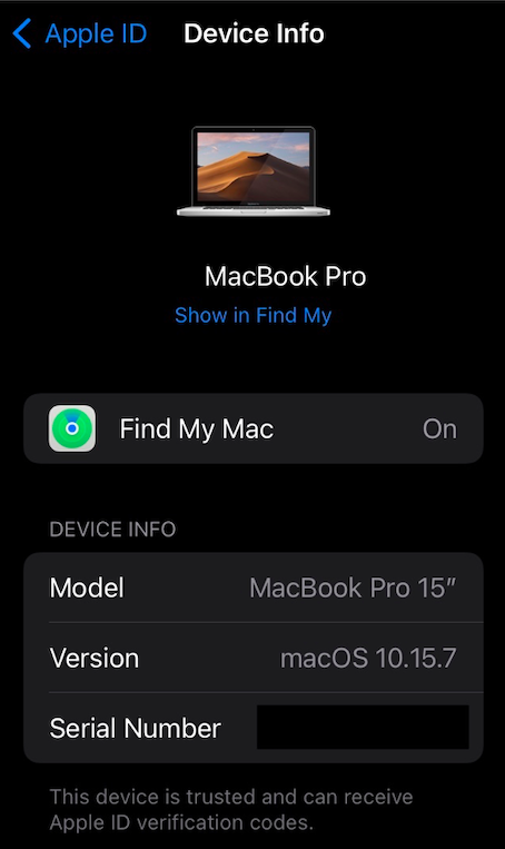

Bizarre, all 3 of my devices show S/N. In iOS>settings>AppleID section at top. I scroll all the way down where the devices appear, select one and for the MBP it shows me the Model, OS version and S/N. The iPhone additionally shows the actual service number and IMEI.
I was only looking through AppleID account on my Mac mini, so thought the difference could be looking from an iOS device - so I checked on my iPhone. No, still just the devices, with the hardware name, but no serial numbers on any device in that list - not even the iPhone that I am using to look at that device information. Just model, and OS version, no serial. There is the phone number and IMEI, but that's not a serial number, either.
I don't have any idea what the difference might be...
@DeltaMac then I got curious and looked via Apple ID on my MBP (it's old), sure enough and not surprising, it mirrored all on the iPhone. It's an OG SE and I recall it showing the S/N of the mac in 2016. Skip forward 2018 and an OG HomePod was added with a S/N displayed.
Stumped why it's not showing on your devices, or why more so on mine. Perhaps someone can join the discussion and check theirs? @steiney perhaps?
Here's a screenshot from the phone pertaining to the MBP, obviously name and elusive S/N blacked out.
Stumped why it's not showing on your devices, or why more so on mine. Perhaps someone can join the discussion and check theirs? @Me perhaps?
ps sorry OP for slightly derailing your thread.
