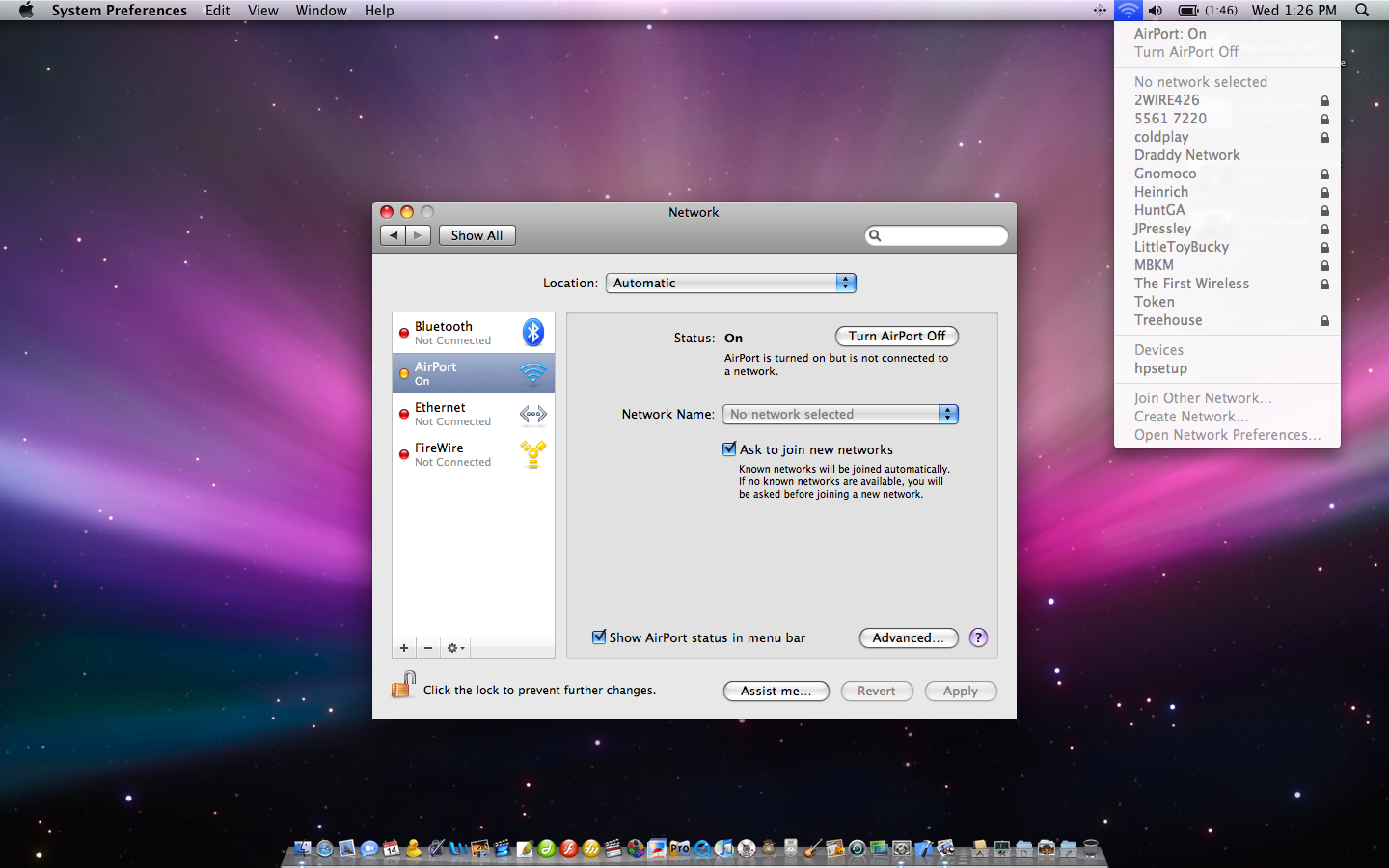

    1st and MOST annoying. within 5 minutes of starting up (from a shutdown state) All of my upper right hand options are greyed out..... airport, bluetooth, date, everything. what in the world!? the only way to fix this is to shutdown and do a PMU reset, and then within 5 minutes, they grey out again. ( and NEVER come back.)

    I would really appreciate some troubleshooting help if you guys don't mind.
