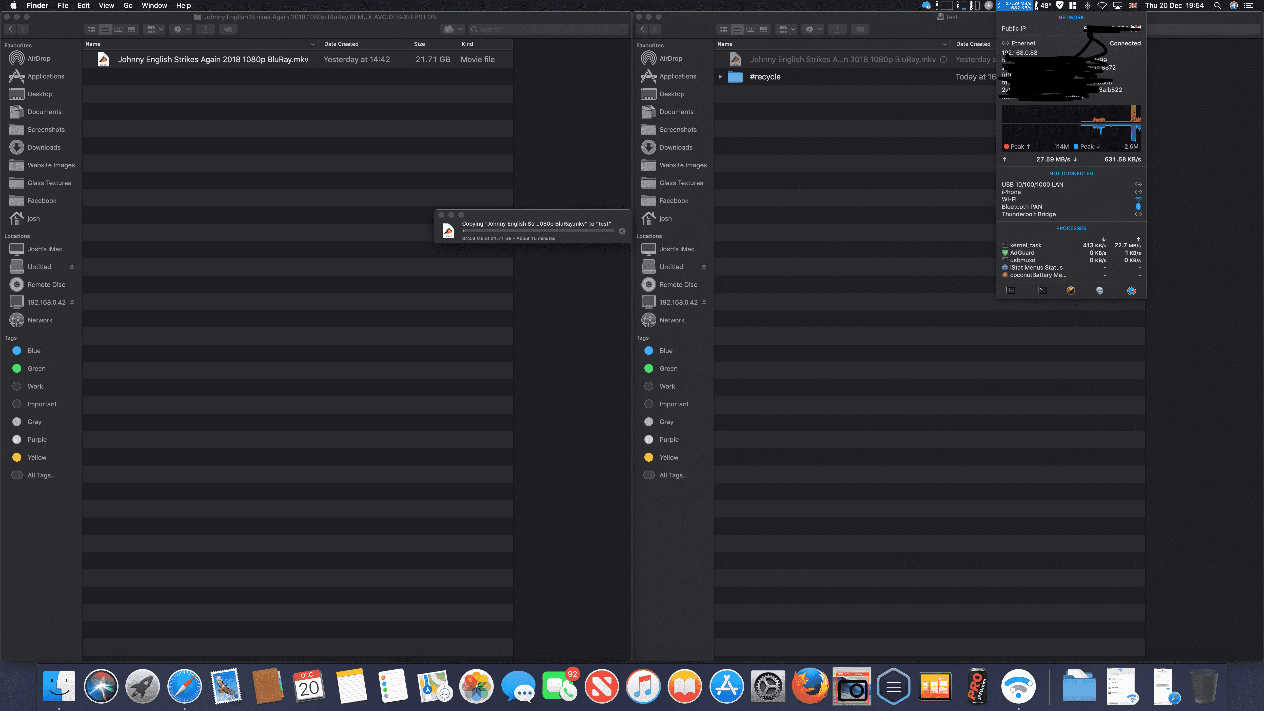

Tranferring to my NAS, my 3TB Fusion drives barely gets above 30MB/s, transferring from the same computer but with a USB3.0 it hits over 100MB/s with a Cat.6 cable so it's definitely not my network or wiring. I'm sure it use to be much better, anyone experienced this? It's a Late 2015 5k model.
I've tested and writing to my iMac from a USB 3 in it hits over 140MB/s, but writing to the USB from the iMac hits about 20-30MB/s again.

I've tested from the the Router > Cat6 > Synology. I've tested 3 different Cat6 cables on 2 iMacs and 1 Laptop, all give 100MB/s. Every test is fine apart from the iMac with the fusion Drive. Also note Wi-Fi is disabled.
iMac with a USB 3.0 in the rear > Cat6 > Synology and you get 100MB/s
iMac Fusion Drive >Cat 6 > Synology and you get <30MB/s
See screenshots below: (Film off the Fusion Drive on the iMac. Cat6 straight into Router > Synology)
(USB 3.0 in the back of the iMac. Cat6 straight into Router > Synology)

Exactly right. I’ve ran first aid on the drive, Its freshly installed MacOS latest version. I did notice after I removed some stuff and got below 100GB of used storage, it transfered at 100MB/s, presumably because it was now stored on the 128GB in-built flash, but even so the mechanical HDD should not be that slow. Tried multiple movies and same scenario. Not had a proper look at any SMART info on the drive yet.

Definitely comparing Apples with Apples. The only difference in the test is the source of the file. Its 1 big file, also the same file. The USB proves that its not a networking error as it achieves full speed.
