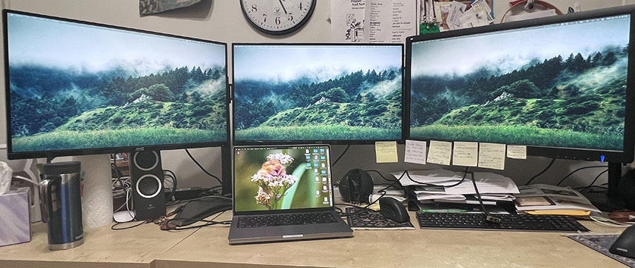

I am getting so frustrated with Caldigit, Plugable, Dell, Belkin, and can't seem to get the question answered I need from anyone, so I'm turning here.
2x 1080p monitors in portrait mode.
1x 1440p monitor in landscape (standard) mode.
My 14" MBP M1 Pro with the lid/main screen open (4 screens total).
I need a dock to run 2 rotated screens (the 1080p ones), along with a 1440p screen at 60hz. I'll need two other USB 3 ports, and that's it. I don't even mind running separate power to my laptop.
Which dock should I purchase. Dell 6000? Something else? Help me people!

Joe, so with my M1 Pro, and my current Plugable dock which gets me two external monitors.
Would I just need a 2nd USB-C to Displayport adapter (like this?) and then run a DisplayPort to HDMI cable to my other 1080p monitor?

This is the dock I have currently, and 1x of my 1080p and my 1440p monitors. are plugged into it: https://www.amazon.com/Plugable-Thu...r/dp/B08HR3T837/ref=psdc_778660_t1_B07JMH6BSY
All I need is to get 1 more 1080p monitor working off my machine.
